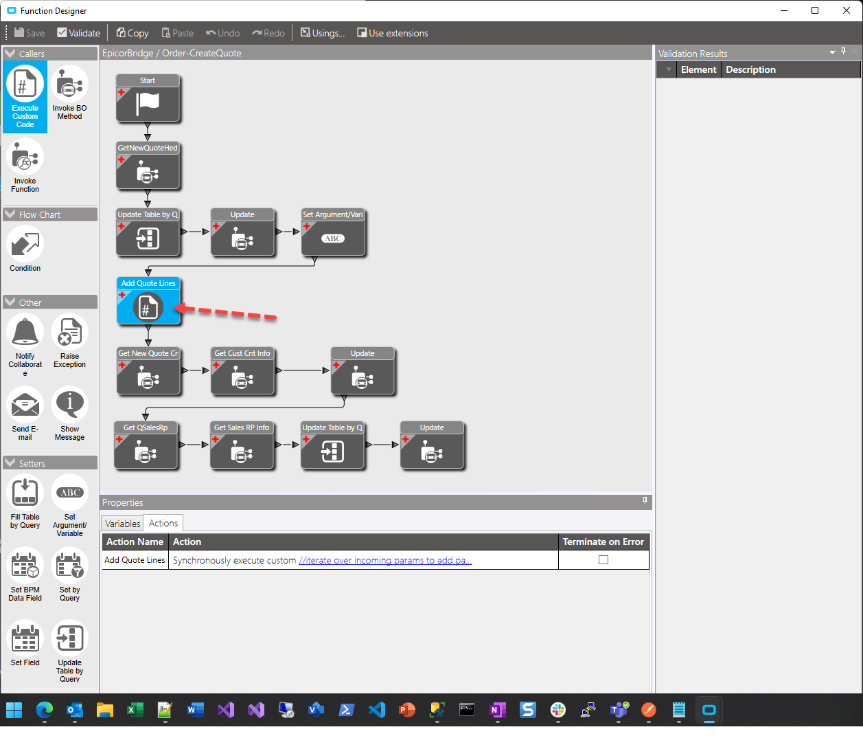

The function itself isn’t fancy, but it appears the first error choked on the custom code block as shown:
The code is as follows:
//iterate over incoming params to add part lines
dynamic prodList = Newtonsoft.Json.JsonConvert.DeserializeObject(productList);
//msg = prodList.ToString();
int rowCnt = 0;
foreach(var product in prodList)
        //Get New Quote Dtl
        this.CallService<Erp.Contracts.QuoteSvcContract>(qs =>{
        qs.GetNewQuoteDtl(ref tsQuote, quoteNum);
        //ChangePartNumMaster
        string partNum = product.PartNum.ToString();
        bool lIsPhantom = false;
        bool lIsSalesKit = false;
        string uomCode = "";
        string rowType = "";
        Guid SysRowID = Guid.Empty;
        bool salesKitView = false;
        bool removeKitComponents = false;
        bool suppressUserPrompts = false;
        bool runChkPrePartInfo = true;
        string vMessage = "";
        string vPMessage = "";
        string vBMessage = "";
        bool vSubAvail = false;
        string vMsgType = "";
        bool getPartXRefInfo = true;
        bool checkChangeKitParent = true;
        string cDeleteComponentsMessage = "";
        bool multipleMatch = false;
        bool promptToExplodeBOM = false;
        string explodeBOMerrMessage = "";
        tsQuote.QuoteDtl[rowCnt].PartNum = product.PartNum.ToString();
        tsQuote.QuoteDtl[rowCnt].RowMod = "A";
        qs.ChangePartNumMaster(ref partNum, ref lIsPhantom, ref lIsSalesKit, ref uomCode, rowType, SysRowID, salesKitView, removeKitComponents, suppressUserPrompts,runChkPrePartInfo, out vMessage,out vPMessage, out vBMessage, out vSubAvail, out vMsgType, getPartXRefInfo, checkChangeKitParent,out cDeleteComponentsMessage, out multipleMatch, out promptToExplodeBOM, out explodeBOMerrMessage, ref tsQuote);
        //ChangePartNum
        bool lSubstitutePartsExist = false;
        qs.ChangePartNum(ref tsQuote, lSubstitutePartsExist, uomCode);
        //Update
        qs.Update(ref tsQuote);
        rowCnt++;
      //msg += product.PartNum.ToString()+ ": ";
This simple deserializes a string which looks something like this depending on the order submitted:
  "productList": "[\r\n{\"PartNum\": \"32247001\"},\r\n{\"PartNum\":\"45647010\"}\r\n]",
and breaks it apart into a list and iterates over it creating Quote lines.
I have not encountered this error before in any testing nor have I seen it in any other cases (so far).
The first thing I will check tomorrow is to see if we can reproduce the error. The second will be to see if I can replicate what data was being passed to me and if that produces the error.
Is there anything else that is obvious to others that might have caused such a failure?

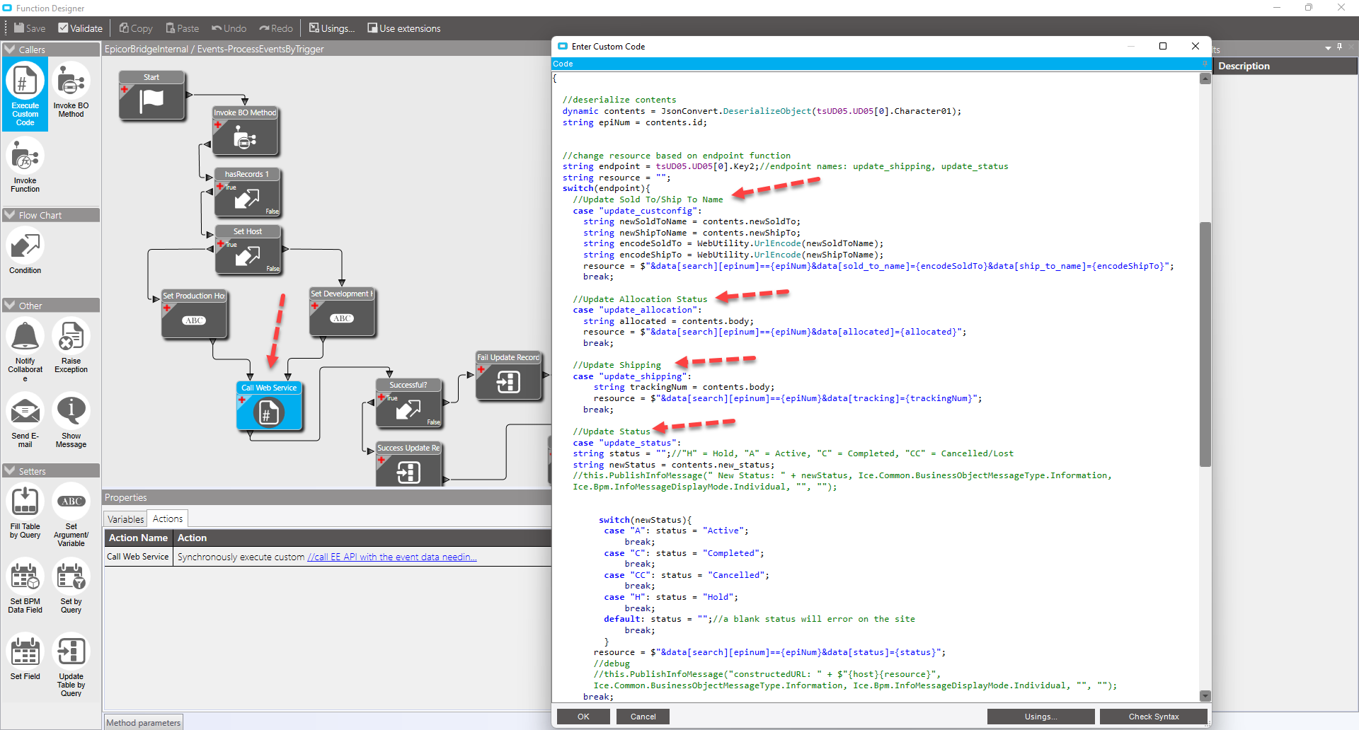

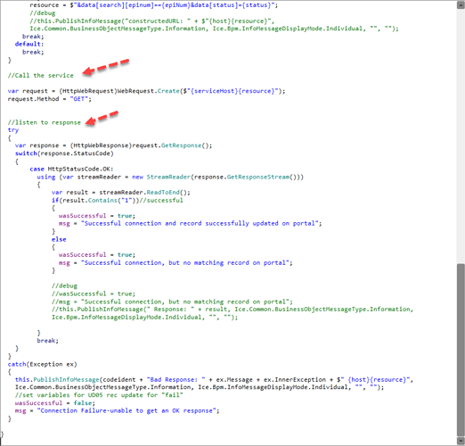

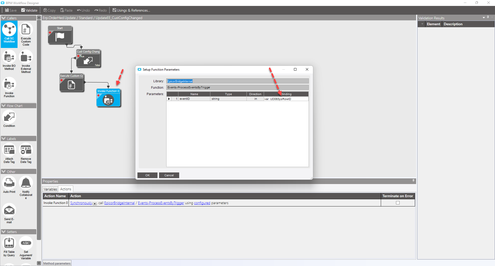

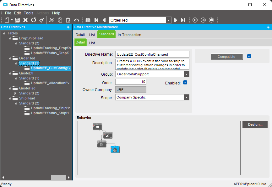

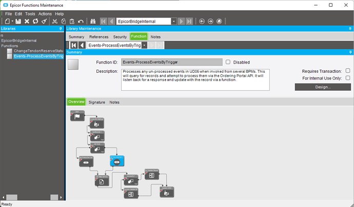

Haha, that’s exactly the design I implemented for Epicor to web app integration. Event listeners are collecting specific events across the system and writing them to a UD table, then invoking a function (passing in the UD table sysrowID of the event).
The function consumes the sysrowID to look up the event and deserializes the contents
and calls the web app web service as designed. Web app does its thing to update the record on the portal and responds back. Epicor listens for response and records it in table.
This actually saved my butt yesterday because we ran into a snag with migrating legacy data over to the new portal. Meanwhile, all of yesterday we ran business in Epicor, so we had potential for de-syncing events on legacy orders.
Today, got the legacy data imported and I built a user process scheduler BPM to re-play yesterdays events against the function to call the web service. Worked like a charm and everything is now in sync.

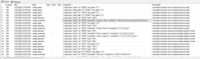

wrapped it up in a try/catch and dumped the incoming variable value to a file. I was able to determine the serialized data I was being sent was being sent incorrectly (missing a comma between json records) and it blew up. Nice suggestion!
I am convinced observability is perhaps the most important part of any integration. Got to be able to pinpoint where it’s going wrong!
