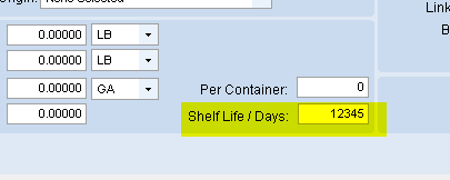

Any reason for a character limit of 3. Cannot go past 999 days.
It’s an integer so it will hold bigger numbers. You’d need to use Extended Properties to adjust the field size.
Now I can enter 5 digits:

Looks like it is totally unrelated to anything else. Maybe you could store the value in weeks instead of days. EDIT: see @timshuwy’s post below for correct answer on usage.
I set my Ext Properties back to the original values, and that field (that was set to 12345) now shows:
I’m not sure what the limits of SaaS MT are.
Can you make Customizations and BPM’s?
If so, make a customization that has a control bound to Part.UserInterger1. And a BPM that copies the value from UserInteger1 to LotShelfLife.
And I was able to change the mask of the original control to show all 5 digits. But changing the value directly in the UI results in a warning

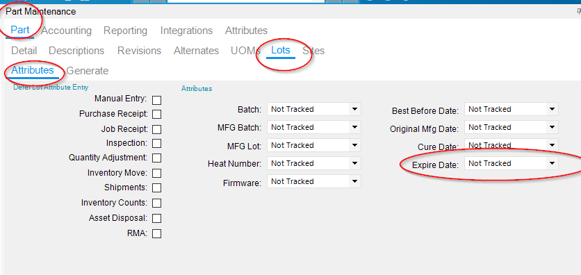

I am fairly sure that this is not just for “Future”… there is a Lot Expiration date in the PartLot table. I believe that it will calculate the expiration date based on the lot creation date + shelf life value.
Then if you TRACK the Expire dates (in Part Maintenance/Lots/Attributes) I believe that you can change the expiration date of individual part/lots in the Lot maintenance program.
