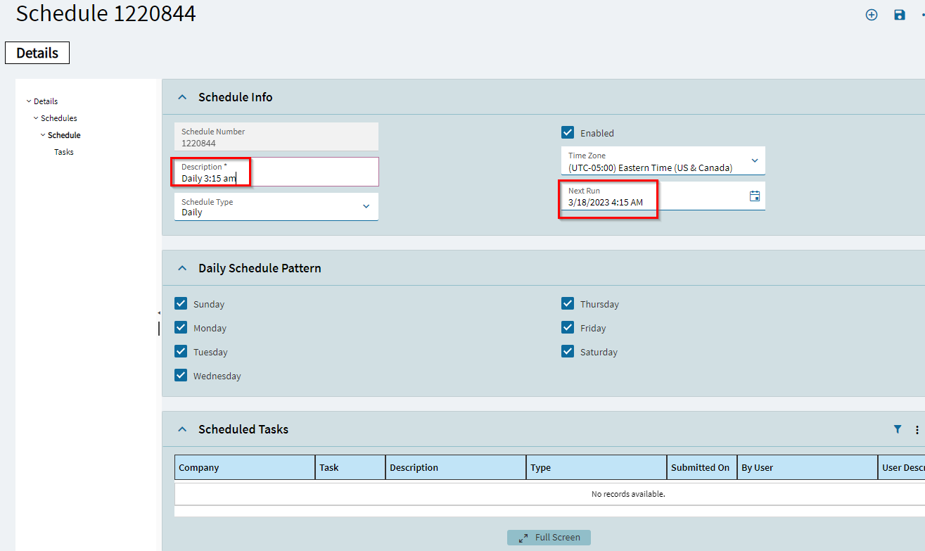

We’re on 2022.2.8, and our scheduled tasks were off by an hour as well. This includes tasks that ran once after the DST shift (5am schedule)… I fixed LIVE, but our pilot environment still shows the difference:
Per the KB, it looks like we’d need to change the time zone for every schedule from (UTC-05:00) Eastern Time (US & Canada) to (UTC-06:00) Central Time (US & Canada). This changes the 4pm one that next run went to 5pm, back to 4pm after DST. Note: It’s not changing the time zone to UTC-4, which is what would make sense to me, but I’m sure makes sense if I did the math between server time, UTC, and local time.
Changing 20 schedule’s time zones to something that’s fake (Central time when we’re on Eastern) individually is almost as much work as correcting the next-run time for all of them. I think there should be a DST box checked somewhere in Company or Site Configuration, and having it happen automatically, like every other bit of tech today. Include Start/End dates if the world has different DST dates for countries.
