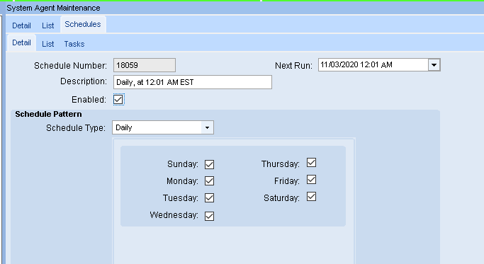

I think the solution is to make the “time to run”, a field in the schedule record. Right now it just uses the time portion of the NextRunOn field, adding however much “time” the schedules interval is for.
If a schedule is like:
When that runs at 12:01 AM on 11/03/2020 (2020-11-03Z05:01:00
in UTC), it just adds 1 day to set the next run time to 2020-11-04Z05:01:00
. But if the DST ended after the the NextRunOn is set, the NextRunOn value of 2020-11-04Z05:01:00
represents 11:01 PM on 11/03/2020.
Had the task agent added 1 day to the date, and used the same time, it would have done:
(11/03/2020 + 1 day) + 12:00:00
That would have resulted in 12:01 AM on 11/04/2020.
I don’t think there’s a good technical solution. Everyone would be complain when there tasks didn’t run because they were scheduled between 2AM and 3AM, and complain about the tasks that didn’t run at the “right” 1:30 AM. (Is the first 1:30AM or the second 1:30AM the right one?)

This really is a solved problem, its just that Epicor implemented scheduling poorly (one could argue incorrectly). Our network switches and routers handle DST flawlessly. My car handles DST flawlessly. Windows Task Scheduler handles DST flawlessly. In fact every IT system that I work with across several companies and plants handles DST flawlessly. The only place I have any issue with DST is with Epicor.
That is the root issue. None of our other scheduled systems operate this way (adding intervals) because it would obviously cause problems with time changes. They all use the actual local system time and execute when [system time = scheduled time]. It is super simple and would be a very easy fix for Epicor. End users shouldn’t have to write custom code just to get software on their system to recognize the time of the local operating system.
