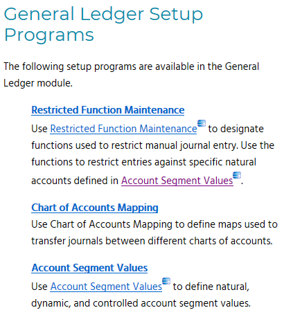

  • Links in the interactive help to open a screen (screenshot below)
Point is, all of those bypass the folder structure anyway.
