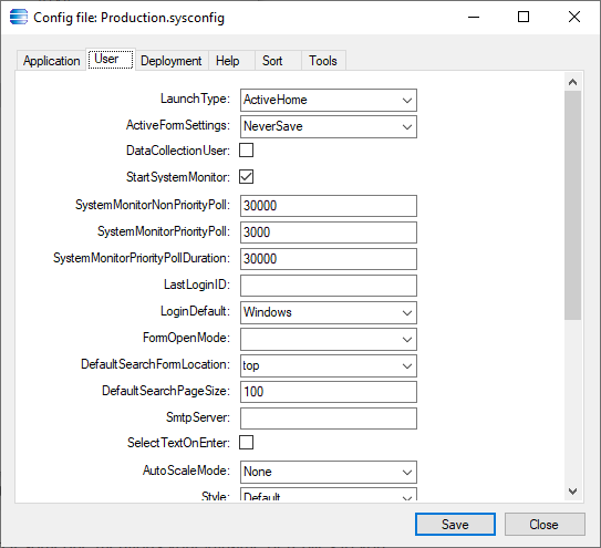

@embedded You can set the machine to be MES only with the config (DataCollectionUser = true)

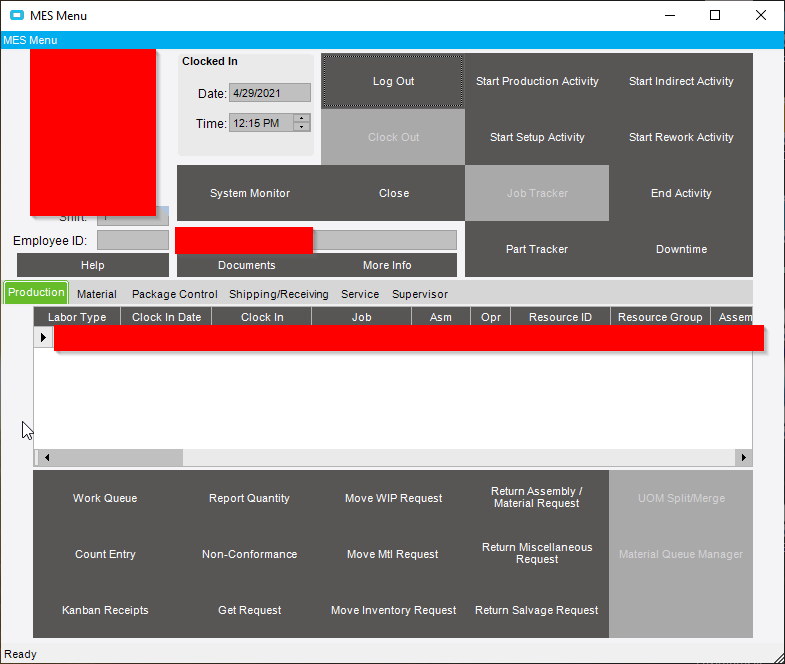

We used the Menu & Security Groups to pigeon hole our MES users accounts to only a few menu options like Issue/Return material, cycle count tag entry, etc. - things they are allowed to do out on the plant floor.

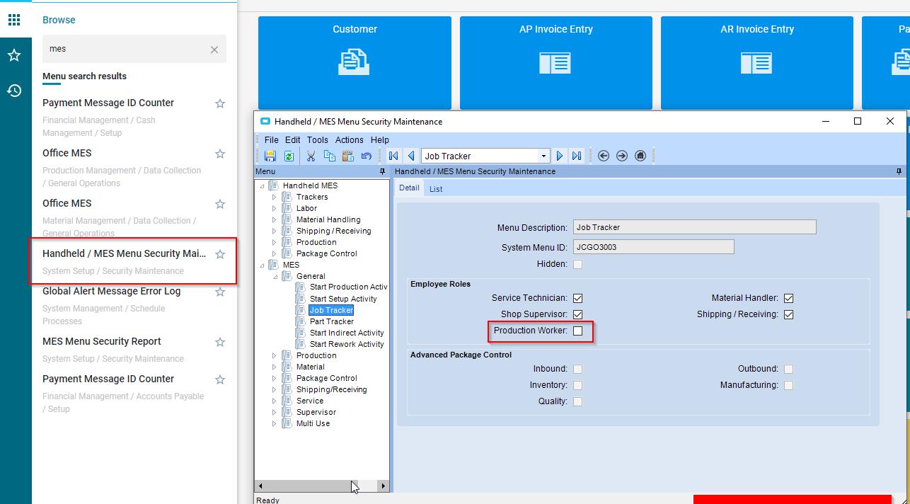

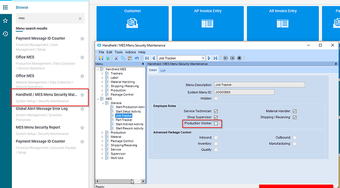

You can restrict items in Handheld / MES Menu Security Maint. which disables buttons and right clicks to those locations.

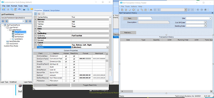

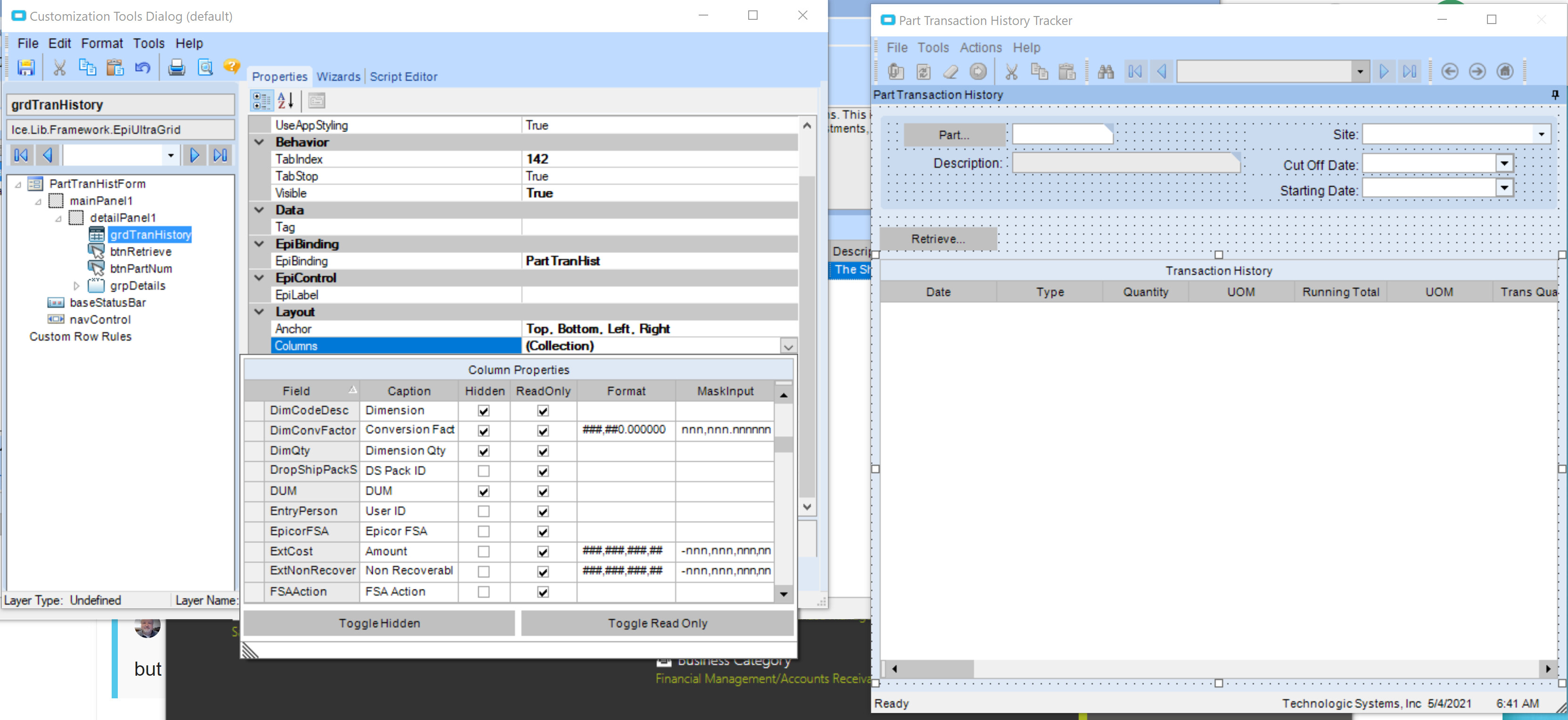

This is great, this is exactly what we want - traceability in regards to who made what transactions!! I attempted to customize Part Transaction history to show the PartTran.EmpID, but unfortunately I don’t see that field listed. The EpiBinding is to PartTranHist(is this a view?), that is it doesn’t appear to be bound to the PartTran table…
Any pointers?
I ran into the same problem. I just rebuilt it with a couple dashboards. One that is the classic transaction history tracker by part, and another that does it by bin. If we are on the hunt for something (usually to fix an issue) we use mine otherwise we in general use the OG screen.
If I remember I did a POST Directive on Erp.PartTranHist.RunPartTranHistory and simply hijacked one of the fields I never planned to use PCID2 and put in the EmpID – then changed the label.

I modified the EntryPerson and simply added EmpID to it.
