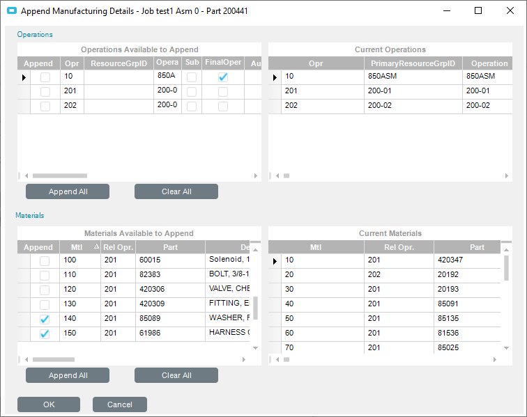

I don’t understand. I think it does a good job of that.
Here’s a quick test I did. I created the job and then deliberately deleted off the last two materials (seq 140 and 150). When I do Get Details again, I get an orange box on the revision screen, and then it checks off only what is not there (see pics below). I didn’t manipulate this at all. Then I click OK and it added only those.
