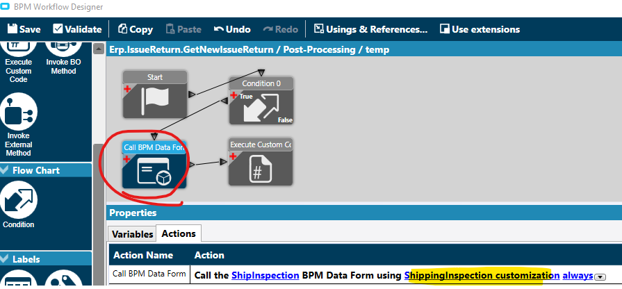

I have a BPM that will call an inspection data form when the process button is pressed. I want to grab the part number of the record being processed so I can provide a link to the drawing in the form for the user to click. How would I retrieve that in the data form customization script editor?

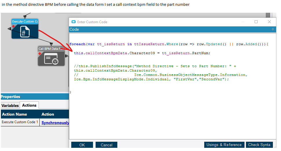

The other option would be setting a BPM context field to the input value then retrieve/process that on the opening of the form. It’s not quite as robust in that sequence/timing can result in the wrong value being retrieved/used if the processing order isn’t as fixed but it’s a very simple/easy option.

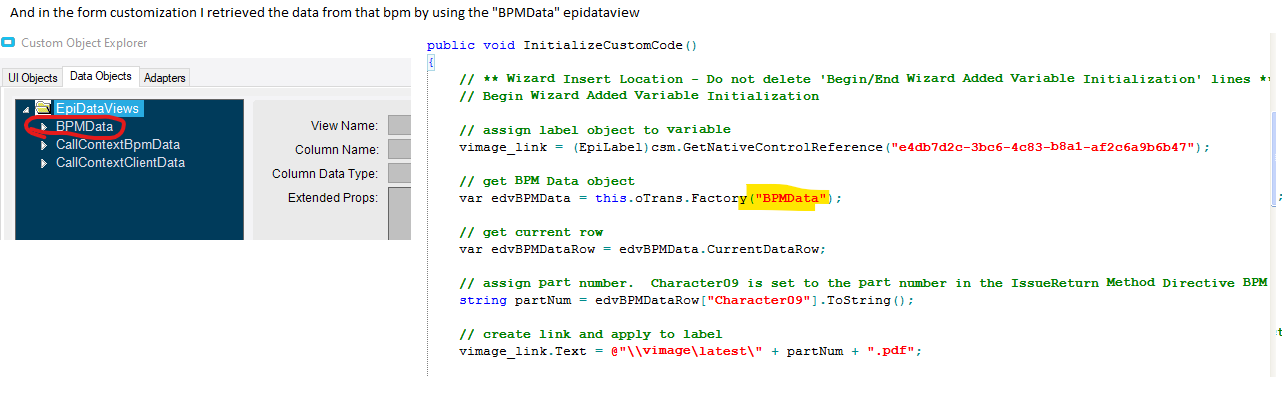

Thanks for the reply Callum. Could you illustrate how to do that? I think that’s ultimately what I need. I know how to retrieve bpm context data within a BPM using custom c# code but not how to do it in the c# form customization code. Form my understanding the bpm is server side and form customization is client side so dont behave the same way
((EpiDataView)oTrans.EpiDataViews[“CallContextBpmData”]).dataView.Table.Rows[0][“CheckBox01”] = true;
I think is the basic syntax to set the value. It’s been a while since I’ve had to.

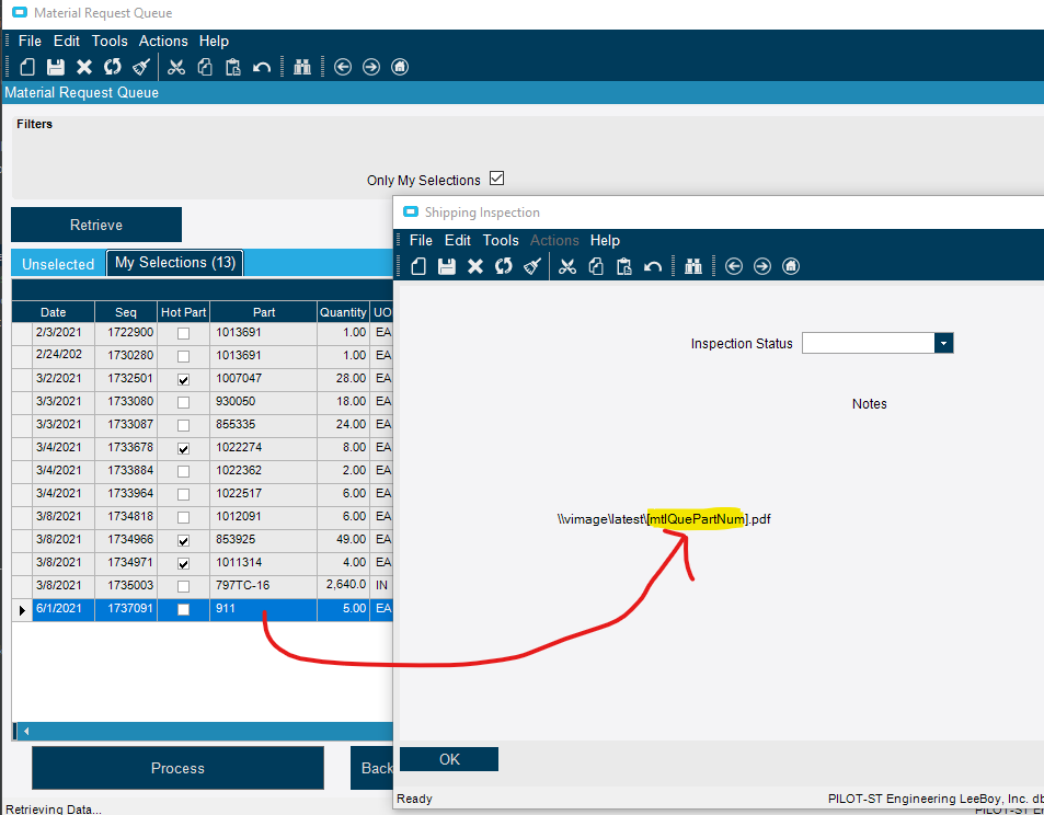

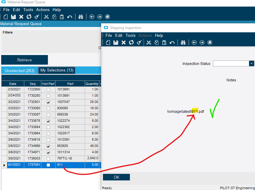

@Callum_Stott - thanks for the code. I got it working with that piece with a tweak. Appears if you set the callContextBPM fields in a BPM the data goes into a “BPMData” epidataview instead of “CallContextBmpData”. Screen shot below of what I ended up doing if this helps anyone in the future that might stumble on the thread.
