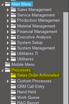

Yea create a menu (process) and launch that
A process is a menu that is not visible in the tree

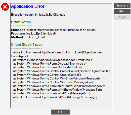

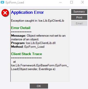

Update. I’ve gotten it to print and close the form… but I keep getting this error. Any ideas?

I feel like it has something to do with the objects not getting created/disposed before you are closing the form.
So you wouldn’t want to run the form.Close on form_Load, but rather do it on Loaded or something like that.
Which would you think would be best?
I usually use _Shown its not in the Wizard list, you must simply add it yourself via code.

Thanks guys. This did the trick. There are going to be some truly ecstatic gentlemen on the Production Floor.

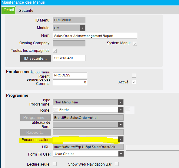

Related question: I tried to apply this same technique to the Sales Order Acknowledgement custom SSRS report. I created a custom menu ID that launches the UIRpt.SalesOrderAckForm program. Then I made a customization to auto-print and set this specific menu item to use that customization in menu maintenance. However, even when I print an acknowledgement through the standard print option in the Actions Menu on an order, it does the auto-print as well. Why did the customization on my custom menu item also persist to the “base” menu which I assume is being called by the print acknowledgement function in Order? If this is unavoidable, any ideas how to overcome this?
Did you specified a specific personalisation in your menu maintenance for the Sales Order ack report Process ?
Verify tha tit is empty:
For us it works great. i created a context menu item where user richt clicks on the order and select the Ack report to print (it is a version for our shipping companies with no costs showing) and it prints and closes.

Pierre,
This is exactly how I have my Context Menu report setup - and it prints great using the customization I specified. My issue is when I try to go the normal way, it also launches with the customization and I don’t want it to. Is there a menu maintenance entry for the standard Acknowledgement report?
Yes,
Under the Process section.
Interesting. Mine does not show there. However, I did find that if I create two menu items, it only refers to one when you print through the Order > Actions menu (seems like it might be the most recently created menu item). Once I figured that out, I set the other menu item to use the customization and for the context menu to point to this one. I have a working solution! Thanks again!!
