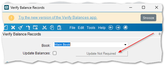

If you pull up Verify Balances, does it tell you that you need to run it?
It says Update Not Required

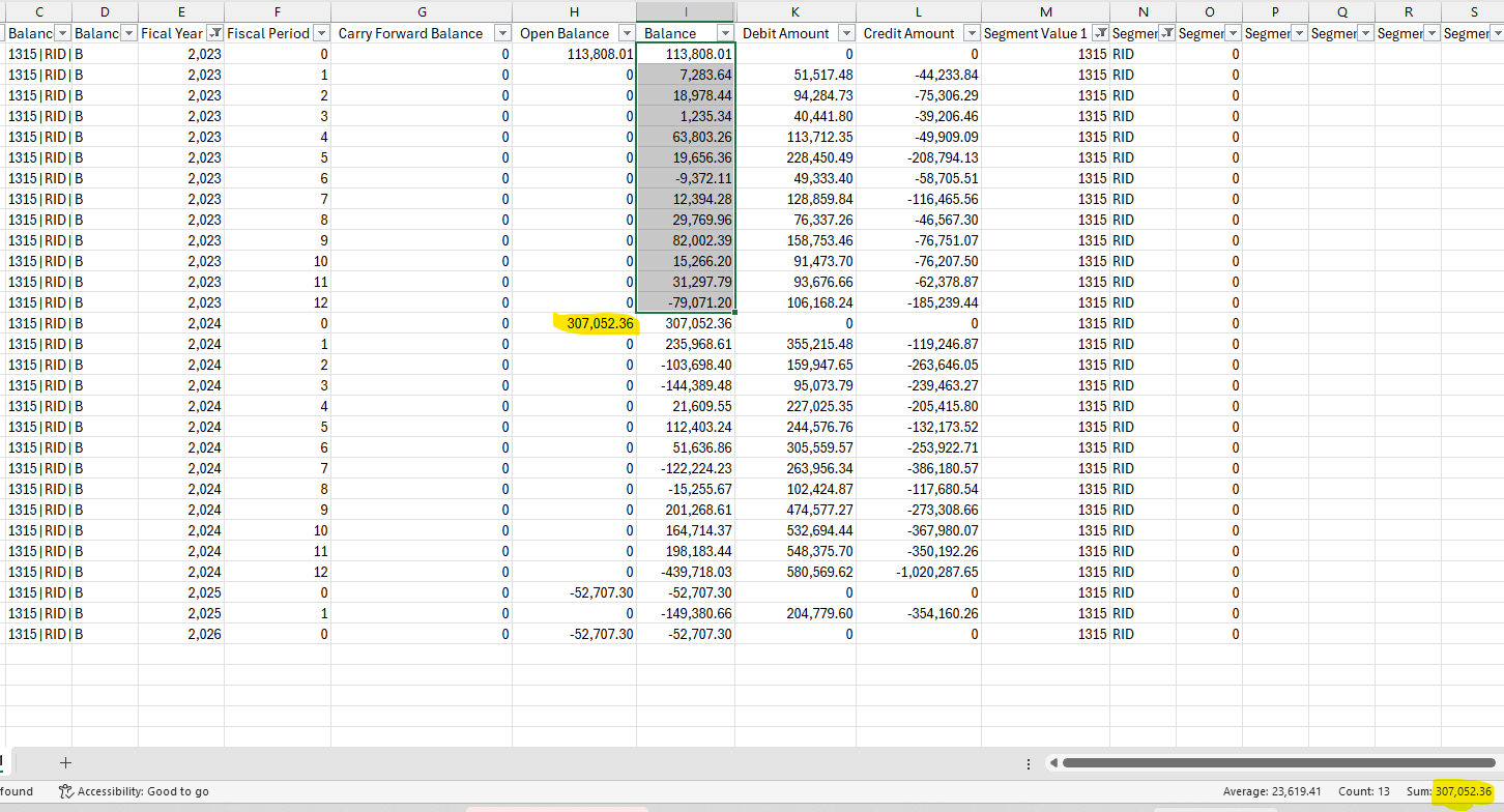

In short, it looks like “period zero” is the only one that stores the opening balance. Then all other math is pulled from there.
Here is a dump of GLPeriodBal (all columns in the order they come in) for a specific account:
Another way to look at this: ignore period zero and you can do a running sum.

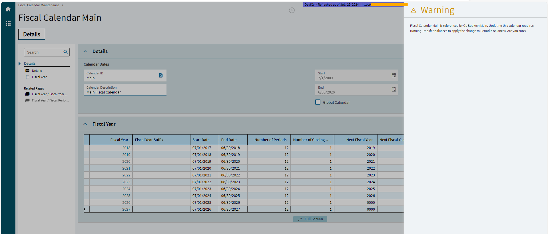

It turns out that back in 2021 we had to make fiscal years out to 2026 because a 5-year deferred-revenue service contract. Well, when you make the new year, it gives this warning:
Fiscal Calendar Main is referenced by GL Book(s): Main. Updating this calendar requires running Transfer Balances to apply the change to Periodic Balances. Are you sure?
And I guess someone did…So we are still living with 2021 data today.
