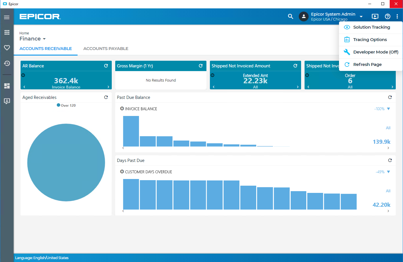

Go get your 10.2.300 people :-)
Much smoother now that it runs Kinetic
You can access it also via Browser
@edge very sneaky, using webpack to bundle it all together.
Besides the homepage, Not much of Kinetic.

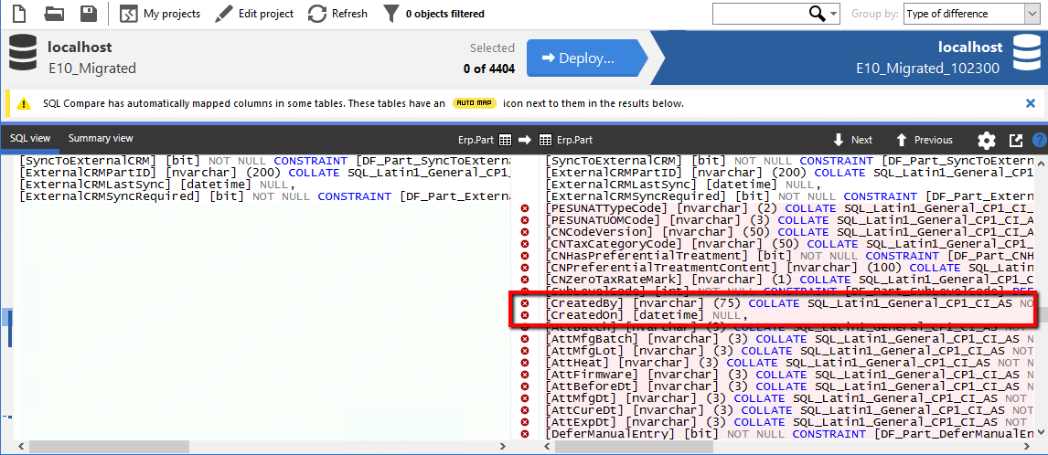

No Way! Is this what I think it is.
(10.1.500.31) Part vs (10.2.300.2) Part
Finally a CreatedBy and CreatedOn on the Part table, no more Querying and digging through ChangeLog in BAQs!

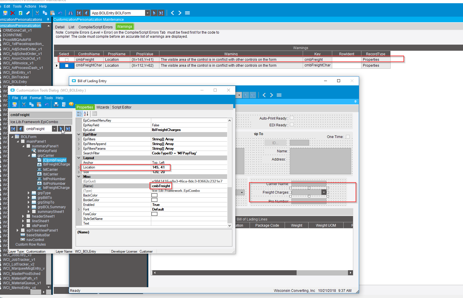

Trying to upgrade customizations and decided to not ignore the overlapping control warnings this go around but no matter what I do they won’t go away. So far 200.14 to 300.2 No BAQ errors, no BPM errors, and very minimal customization errors, just things like this that I force validated on 200. is there a trick to these location conflicts?

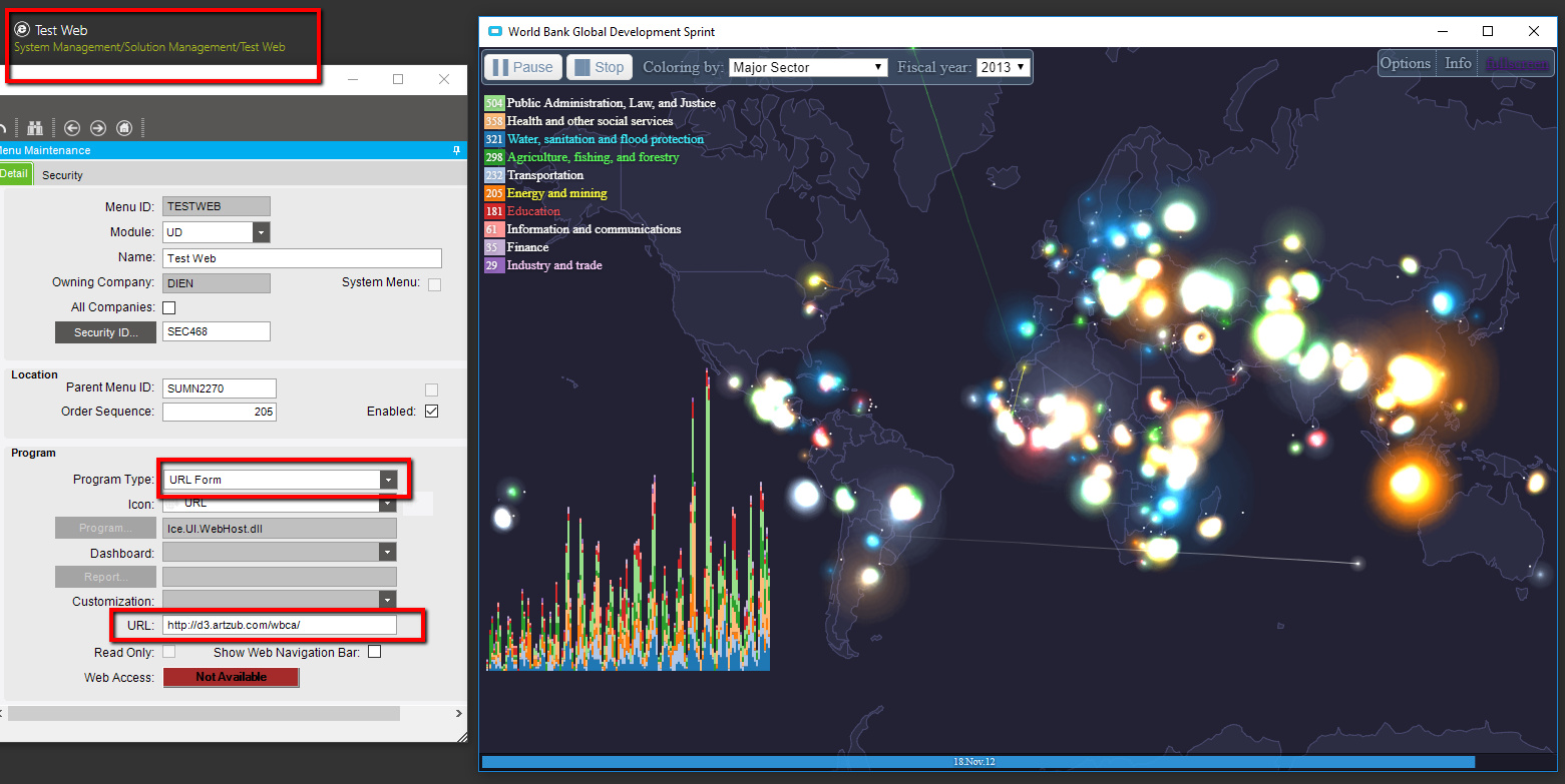

Epicor 10.2.300 Menu Maintenance let’s you select a URL Form now. This is going to be GREAT for anyone who has external web-apps, QlikSense, QlikView etc, or a full-width dashboard that creates gauges and charts from data retrieved via Epicor REST. The best part it runs EO which is a Chrome based web view, so you can make use of latest web technologies like WebGL, SVG…
Now if Stephen @Edge makes it happen as we use LaunchForm that we can pass in ?params then we can use it also as a pop-up to fetch more data,visuals for a given record.
You can Embed a webpage in the Active homepage and there are checkboxes to send the Context & Token to the website you are embedding, it’ll pass it in as various GET params ?token=… and then you can use that to call Epicor REST.

@jgiese.wci - Maybe increase the spacing between the label and Freight Charges combobox? I had to pop in a help ticket (Case CS0001143349) for similar issues on an 10.2.200.x, and requested an enhancement to reduce the padding and not warn for overlaps. Dan D. noted issues like this for enhancement in future releases…
The Problem Case Number is PRB0206232 and has the following Description:
SUGGESTED ENHANCEMENT #1: Improve Verify algorithm in Customization Maintenance to eliminate false “Visible Area” Location Warnings by ignoring padding and only looking at the control itself (i.e. label or text box) and not the handle squares around it.
That was my first guess, added 8px between them to start then 12px and still wasn’t resolving. At that point I determined I’m wasting more space than actually fixing anything LOL
