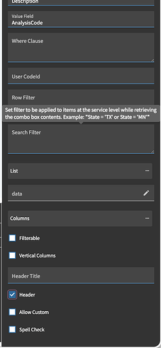

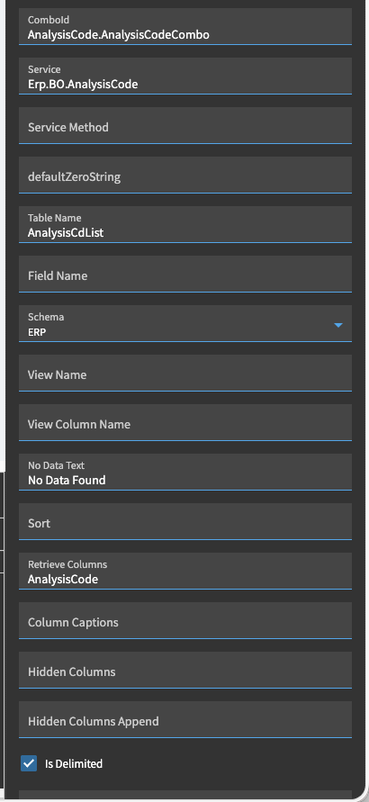

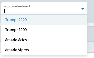

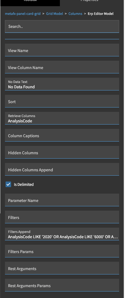

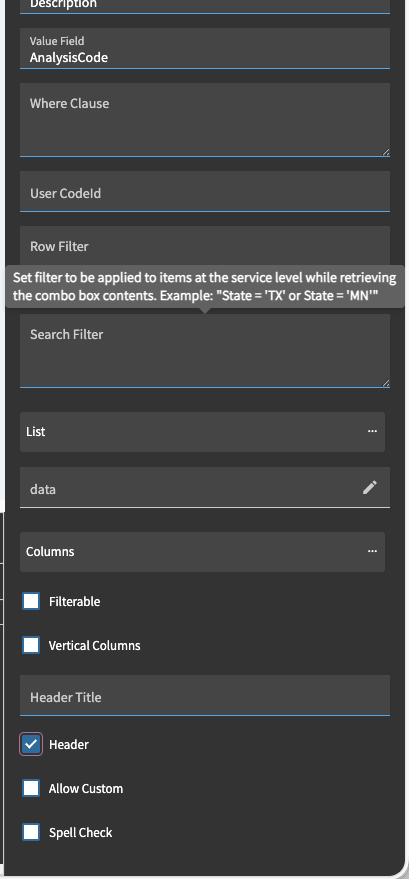

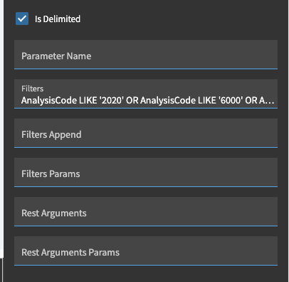

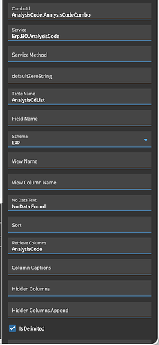

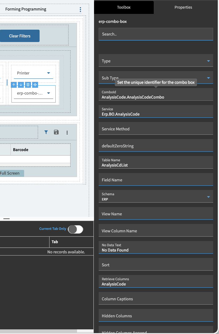

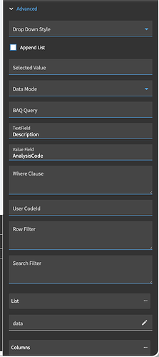

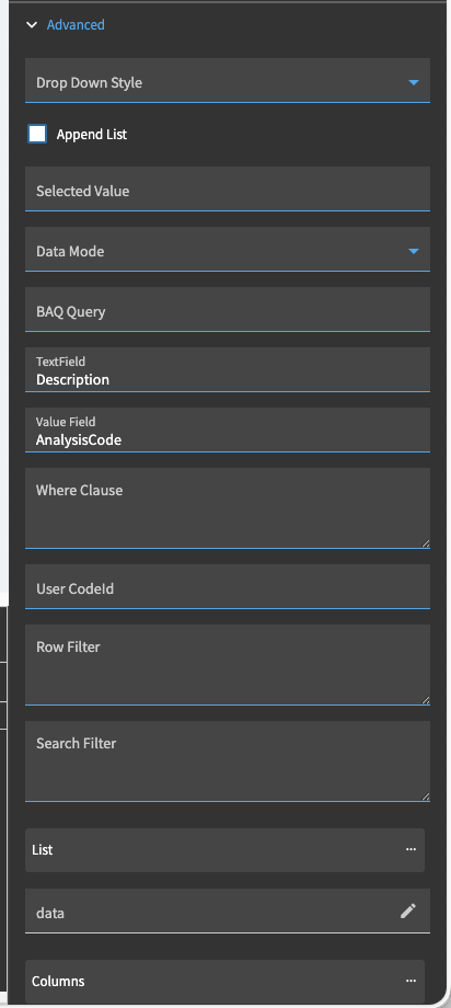

Hi all! My combo box ERP Editor in the Grid, while the same setup in a panel card, has different results. Trying to wrap my head around this, because the grid combo box is wrong.
Panel Card Combo Box
**Note : DropDown or DropDownLst has no effect, I changed this to match the grid after I took the screenshot. **
Grid ERP Editor ComboBox
Results
Grid
Panel Card

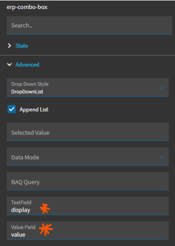

Try the values ‘display’ and ‘value’ for properties TextField & ValueField respectively
Like so
No Dice;
Grid Still shows the incorrect mapping.
Thank you though!
On your Grid Reusable Combo setup, put Description in the Retrieve Column field instead of AnalysisCode. I don’t know why it’s doing it but the grid setup was putting the two columns (Description & AnalysisCode) out of order in the GetList call, resulting in you seeing the analysis code instead of the description.
Thank you!! That worked!
