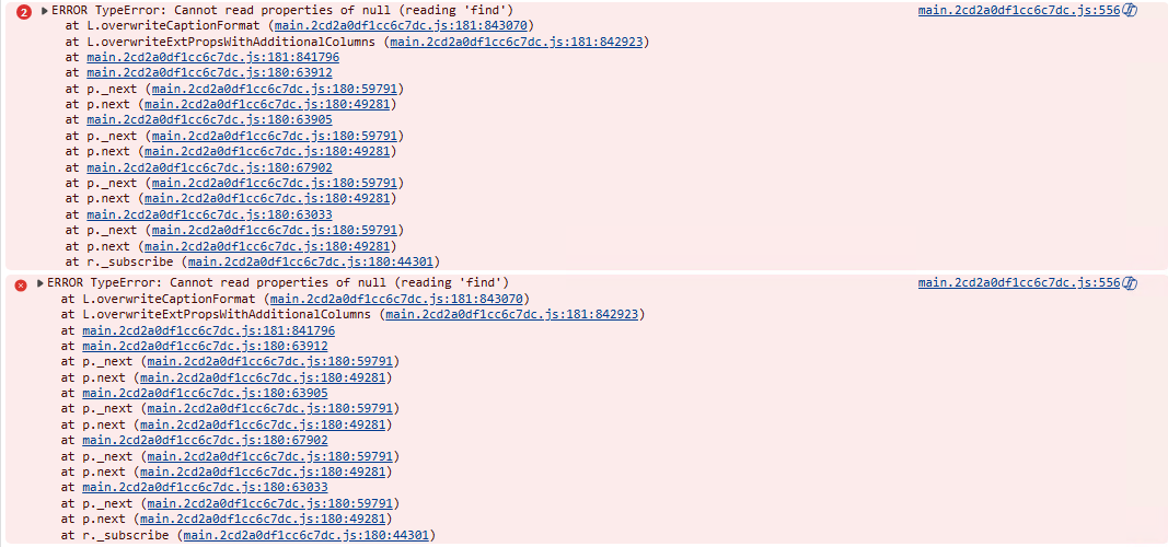

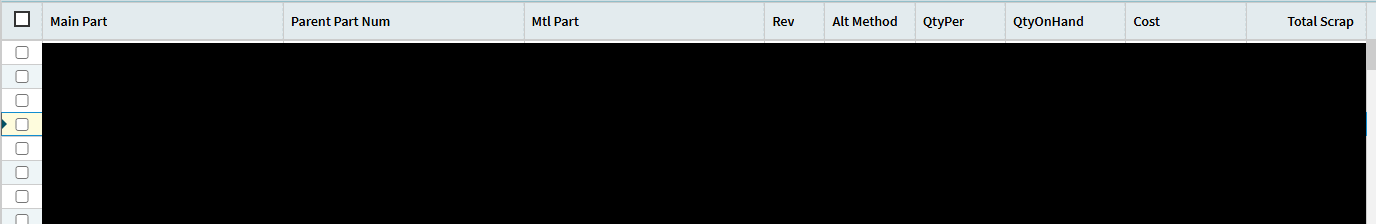

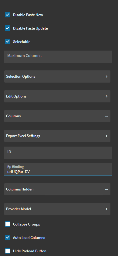

I’ve got a grid that is bound to a custom dataview and is loaded from a function called by a button click. The data populates fine and now I want to display some other data in another grid based on the row that is selected in the first grid. But when I select different rows in the grid, no events are firing. There are some javascript errors that look like below, but nothing else.
I do have selectors enabled for the grid, not sure if that would hinder events from being called. Even if I select a checkbox, an event doesn’t fire. Has anyone experience this?

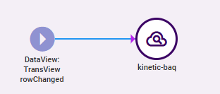

Changing the active row, yes. But you have to build that event. It would have a trigger of DataView > Row Changed.

Your child grid is going to be populated by a BAQ or rest call to a BO method. So in your row-change event, you would then perform an erp-baq (or rest-kinetic if you’re using a BO) using the parent’s dataview.column as the parameter in that call.
So, changing the row in the parent grid triggers the event, and the part number in that newly selected row is then used as the parameter to filter the child grid.

It’ll look something like this:
whatever dataview your parent grid is bound to… when the selected/active row changes… it will fire your kinetic-baq (or again, you can do a rest-kinetic here, instead, if you’re using a BO rest call to populate your child grid).

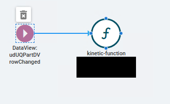

I guess I didn’t make myself clear. I already did that. The event is not firing at all. Not for row-changed or changing. I also tried tying off the data table as well.
Can you show your parent grid model and what dataview its tied to… and the event you’ve built?

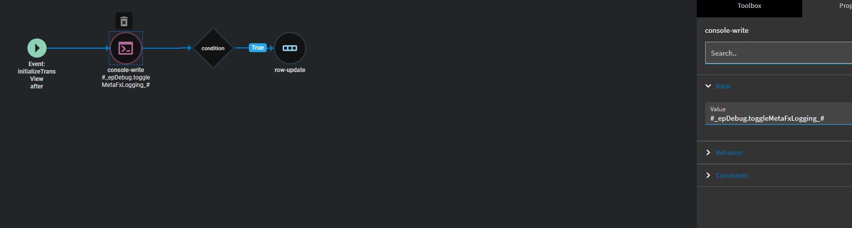

(CTRL+Alt+8)… or typing epDebug.toggleMetaFxLogging into the console
One of my favorite things to do is turn this on right away by doing a console-write before i could even interact. like below:

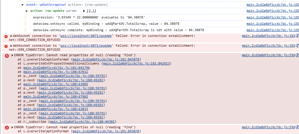

Yes debugging is on and no I don’t see the row change events firing. I know some events are firing because as the grid loads, I update a calculated field in the dataview and I see those events firing.
Below is the last of those events. The grid loads fine and when I click a row those errors pop up you see below. Also, a separate issue, I set the selection checkboxes to true and I have to click the select all checkbox like three or four times for them to uncheck. I do this as test in case the user needs to do it and I would think they would find that annoying as hell… But I guess that would be a different thread.
