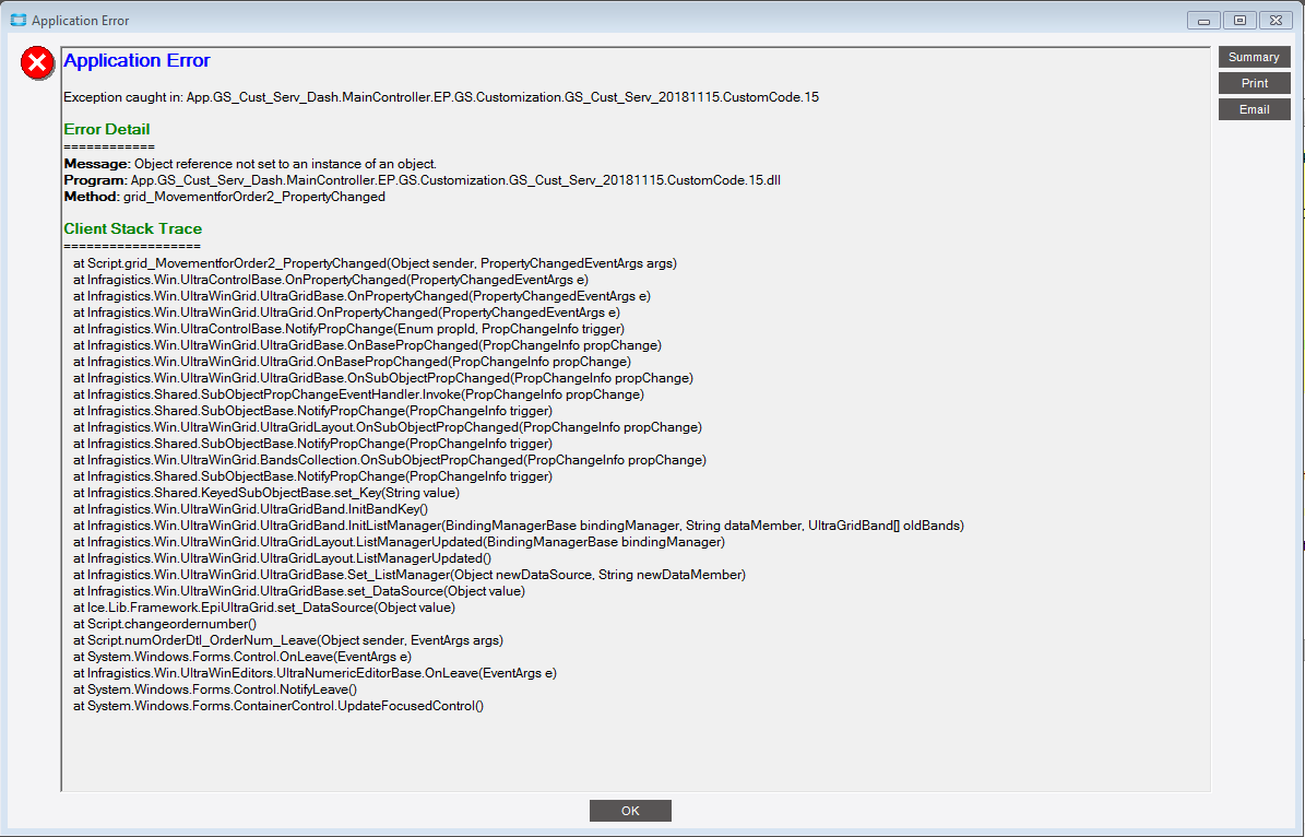

I have a Grid that once populated from a Dynamic Query, I would like to have text boxes populated with the top record. I don’t want to use the foreach method because it runs through the rows in the grid.
I have an event on the grid of Property Changed. When this event occurs I want the text boxes to be populated with the row data. I have this so far but I am getting errors.
		UltraGridRow activeRow = grid_MovementforOrder2.ActiveRow;
		dbMovementCreateDate.Text = activeRow.Cells["UD091_Date01"].Value.ToString();

Okay, I did that and added some Message Boxes to see what is going on. See code below:
	private void grid_MovementforOrder2_PropertyChanged(object sender, Infragistics.Win.PropertyChangedEventArgs args)
		UltraGridRow activeRow = grid_OrderMovement3.ActiveRow;
		MessageBox.Show("UltraGridRow ActiveRow");
		if (grid_OrderMovement3.ActiveRow != null)
		MessageBox.Show("Not Null");
		MessageBox.Show("1st Value Entered");
		tbMovementCreateTime.Text = activeRow.Cells["Calculated_CreateTime"].Value.ToString();
		tbMovementFromDeptDesc.Text = activeRow.Cells["UDCodes_LongDesc"].Value.ToString();
		tbMovementFromDept.Text = activeRow.Cells["UD091_ShortChar03"].Value.ToString();
		tbMovementToDept.Text = activeRow.Cells["UD091_ShortChar04"].Value.ToString();
		tbMovementToDeptDesc.Text = activeRow.Cells["UDCodes1_LongDesc"].Value.ToString();
			//Hide Buttons if Order is not in 99
			if (tbMovementToDept.Text.ToString() == ("99"))
			btnShipstore.Visible = true;
			btnCreateNon_Conformance.Visible = true;
			else
			btnShipstore.Visible = false;
			btnCreateNon_Conformance.Visible = false;
		else
			MessageBox.Show("Is Null");
I am getting these Message Boxes: UltraGridRow ActiveRow and Is Null. So that is telling me it is never seeing this row in the grid as active. Is there another way to call the grid results without actually having to click on the row. I need it to populate the text boxes once the grid is populated with the first row data.
