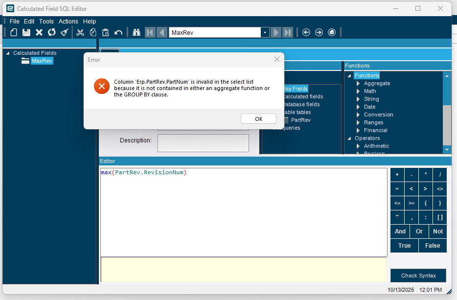

So I’m not well versed in query language, so forgive my ignorance but I’m so lost with the whole Group By and Aggregate function thing. I’m just trying to make a BAQ that gives me a list of all my parts and part rev data but only for the latest rev.
So I assumed that I can create a calculated function that gets the MAX part rev and group by the part rev. I did that in a subquery because there is a bunch of other stuff I need from other tables. and just keep getting that PartRev.PartNum isn’t in an aggregate function or group by, but if I include it in the group by I get multiple entries in my subquery and not the latest rev only.

There are some potential issues in that PartRev.RevisionNum is a string instead of a number, but for the most part it shoulld work.
If I’m reading correctly, this is what you are facing:
This is actually an easy fix, but it’s confusing to read. The key is to just hit ok and then click the group by box here:
This should give you what you are looking for on this query. Trying to see if I can dig up something that explains things a little better.
Yeah, that was my thought! But the issue is that once I add PartNum to the Group By, I end up with multiple entries (2 entries) for the same part instead of it just showing a singular entry for the latest rev. :frowning:
What all fields are you displaying, just the partnum and calculated max rev and what tables are you including? You should only need the partrev table itself to get this. If you are trying to pull more information, you need to put this into a subquery to feed into the top as once you add in other fields, you will get more rows per part.

Unfortunately there are a TON of fields I’m bringing in from multiple tables…such as the following (and more):

Essentially I need stuff from part, partplant, and partrev(so far) and need the data to be consolidated by the latest rev only, The other struggle is that we have 2 different sites and I’m getting the sense that folks want to not show both as well.

You have a couple of ways to do that.
One is the windowing functions filtering technique that I show in the video.
The other is to make a subquery with only your selection fields (Company, part number, max(rev) etc.) that ONLY has what you need to ID the proper record. Then you bring that into your top level and re-join it to your table so that selection sub filters the info table so you can get the other extraneous data that you need without the pesky problems with the extra fields making group by not work because of non-matching data
I would probably recommend the latter, as it’s a bit simpler to create, and probably more efficient.
