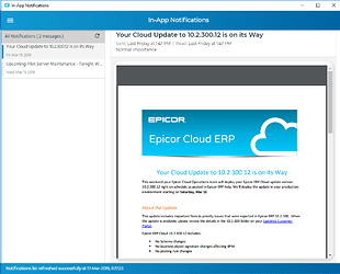

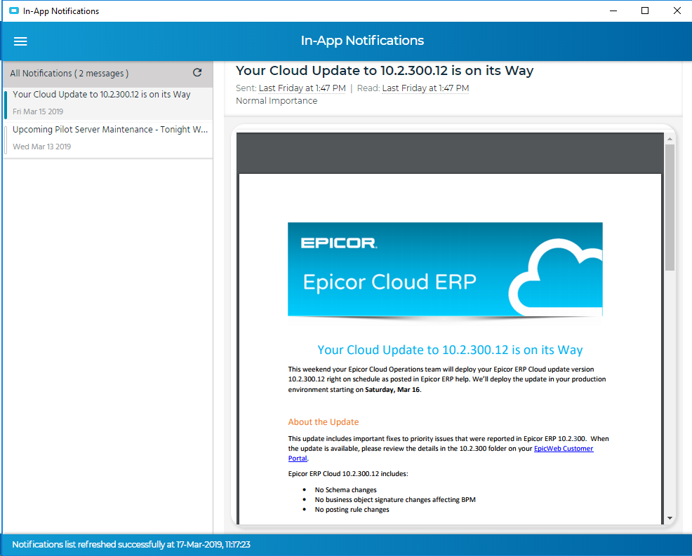

I am curious now if push notifications from server to client are a thing.
10.2.300 has notifications but that’s all that I’m aware of and even that is just for Epicor Global Admins to communicate with Cloud Users.
Not sure what it would take to hook the System Monitor or the Client to register with an Azure Notification Hub.
