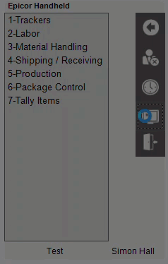

I’ve got labels working as custom code bpms, I ended up testing for the assembly as we had specific labels based on customer forms, so that works, I’ve also added a menu based on some of your direction in other posts. I’m thinking Iight ba able to advance button to the menu to drive the workstation change, but at least we have the fallback of multiple AD users… @Chris_Conn sounds like you were in the same situation as us, not having the numbers of employees to only perform only one part of the process as Epicor expects.

This is my attempt. Created a simple BAQ/Dashboard with a tracker deployed, added a button to the assembly as a customisation, Modified the Erp.Menu.Handheld to add a new button and label so show the workstation. Then used the process calling example to tell the menu that the form has workstation was changed, then just @Chris_Conn/@hkeric.wci code to refresh the Workstation label.
Dashboard is a bit clunky but it appears to work. Just need to check the prn parameter in the bartender reports to confirm it is picking things up correctly, but I think it will be.

Also meant to mention theirs a setButtonImage method in the Erp.Menu.Handheld assembly

. Thought I might make it “A one way to do it” how to… Was going to put it in code review, I’m sure there are some refinements that can be made, but for a first attempt I was chuffed it worked pretty much first go!
On the menu the new button I added for the workstation (second button from the bottom)
