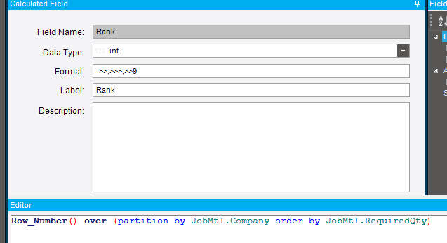

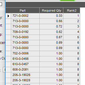

I think you want to use Row_Number though, because rank might not separate ties?? (I would have to test to be sure.
@knash explains it here.
https://epiusers.help/t/baq-return-only-1-row

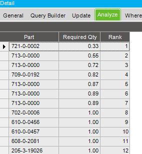

Here’s an example of using Row_Number
edit And I really should not have called my field RANK because it’s not, but it works… Just don’t get confused.

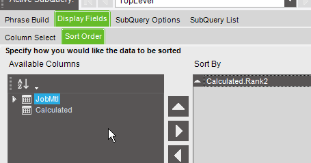

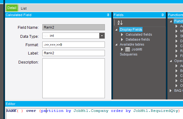

So I did a test with RANK() because I was curious, I was right about ties.
side note: you can’t call your field rank, or SQL will choke. Hence why it’s now rank2

It will go by whatever you are ordering by. (see the second part of the calculated field) So you can order by DAYSOPEN desc and the most days open will show on the top of the list. You can also order by more than one thing to break ties. Check out this link. It will explain it better than I can.
https://docs.microsoft.com/en-us/sql/t-sql/functions/row-number-transact-sql?view=sql-server-2017
Does that make sense? I don’t really understand what you mean when you say "row 1 is rank 1 ” etc. If you need them in that order, you should put an order in your query then the first row with always be Row number 1 etc.
Here’s the SQL if that makes more sense.
select
	[JobMtl].[PartNum] as [JobMtl_PartNum],
	[JobMtl].[RequiredQty] as [JobMtl_RequiredQty],
	(Row_Number( ) over (partition by JobMtl.Company order by JobMtl.RequiredQty desc)) as [Calculated_RowNumber]
from Erp.JobMtl as JobMtl
where (JobMtl.JobNum = '403413-1-1')
order by RowNumber
