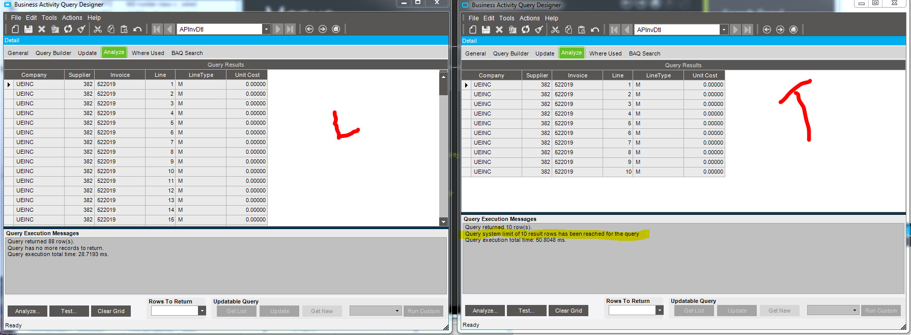

I’m seeing something curious today. I have a query on live which I copied to test. All it has is APInvDtl filtered by invoice number 522019. On live it shows 88 rows, on test it shows 10 rows. I have Rows to return = blank, both queries are Type: TopLevel with ResultSetRows: All
Is there anything else that would limit the results? Am I in Demo mode?

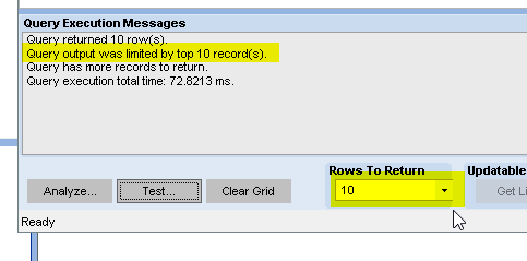

Have you tried running it with “Rows to Return” set to something like 100?
EDIT
Hmmm … I set a BAQ to 10, and the wording it uses is slightly different than what you see

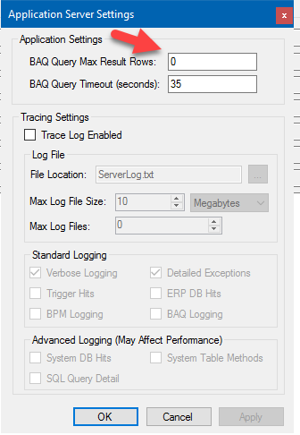

In your application management console, click on Application Sever Settings.
What’s the setting in the BAQ Max Results Rows entry?
I did a test where I set that field value to 15 then I ran a query
This is the same message you got.
Thanks for the help guys, that was it. It was set in the app server. Now to figure out who set it! That was annoying!
