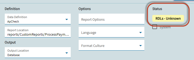

We just updated our pilot environment from 10.2 to 2024.2 last week and im wondering if we missed a step.
should the report style be saying this in the kinetic view.

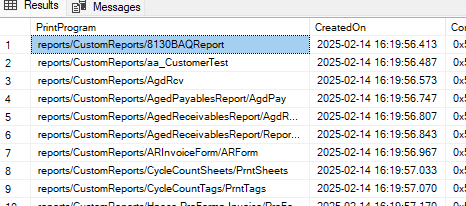

No, check your Ice.CustomReportStore table. It should be listed in there if all of the conversions have run.
it looks like we ran the conversions and we have data in that table.
that was the date of the upgrade.

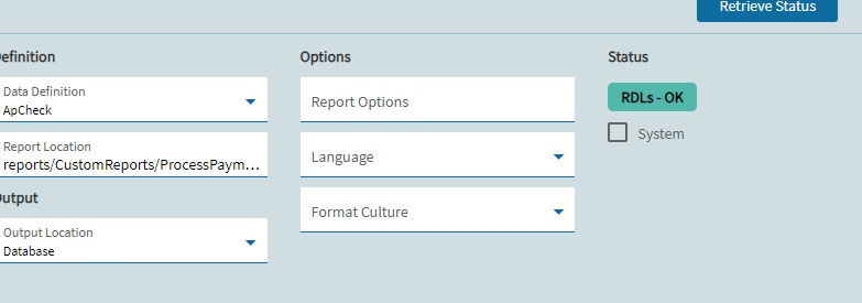

we downloaded the RDL , renamed it made our change and uploaded. Changed the path on the report style and it now shows RDL OK.
Great, you should also see an entry in the Ice.CustomReportStoreHistory table with your changes.
We had some problems during our upgrade which imported the reports with the wrong PrintProgram path. I had to manually update the paths to have the RDLs be detected.
That is a clickable button as well. Sometimes it just says that on a new report, but if you click it it turns green.
interestingly enough, the dB table customreportstore did not update with the new RDL name.
We ran into the exact same issue with the upgrade. If you create a new report style it is not added to the CustomReportStore tables and is not overwritten in SSRS when you print. Likewise, we tested removing the records in those tables for an existing report style and that works as well. Obviously there is some sort of bug here somewhere. We are trying to work through this with support to uncover whatever the underlying issue is.
please ask them to report it as a bug. thats what i did and they said they will need to investigate.
The CustomReportStore tables not being updated after after report style has been copied has been reported as a bug. The only way to populate the data in those tables is to run the ImportCustomReportsFromSSRSServer conversion process again. However, once the data is populated in the CustomReportStore tables, we have been unable to successfully modify the report by going through the Generate for Design / Publish process. Perhaps whatever is blocking the new report styles from saving is also effecting the publish process.
