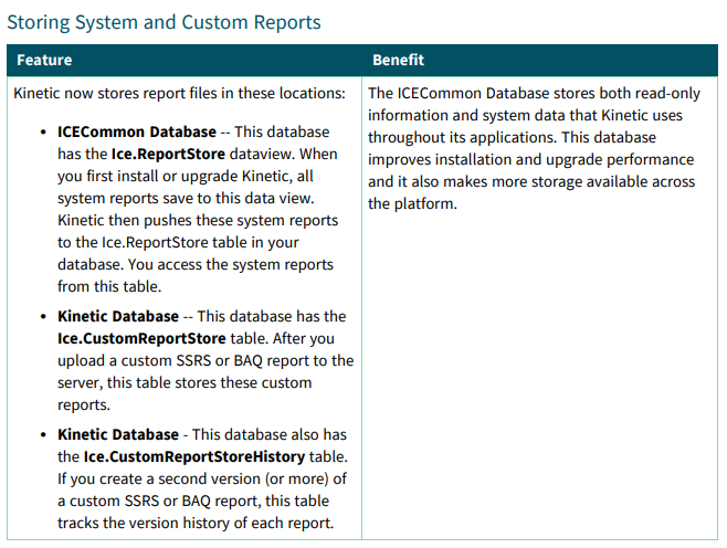

Keep in mind that SSRS reports are stored in the database now
