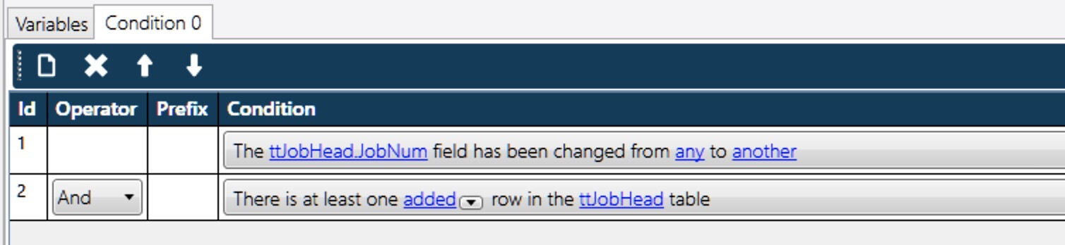

I think you could add a check for added record to your condition. Like this:
I thought about that, but there are no temp tables for the ValidateJobNum method.

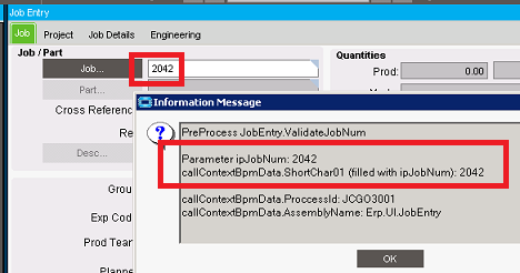

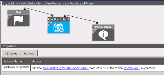

Hmmm… I wonder if you grab the parameter - ipJobNum
store ipJobNum in a BpmData field and then do you condition check on that?
