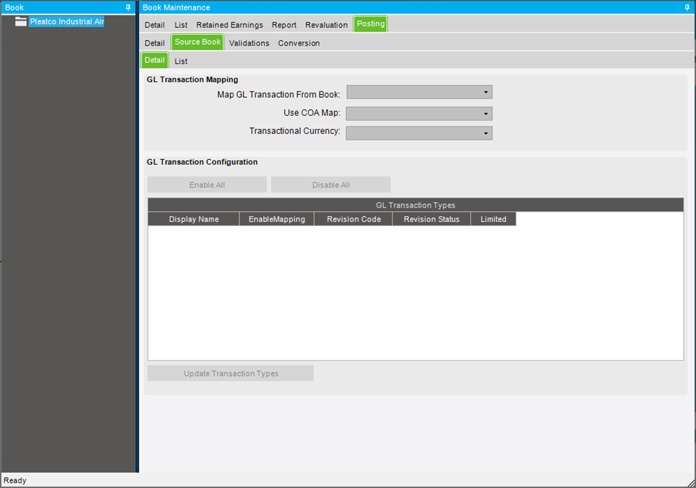

  2. Define additional book with different currency - and map it to main book, system will auto post the transactions in second book according to the rates defined.

Option 2: would be adding a second book and pointing it to the first in the screen below. So Accounting can print the “other currency” book with all the transactions. So anything posted in the other currency would show in the second book as that currency and then in the main book as the default usd currency?
thank you so much
Thank you i went with solution 2 and it works. the screen above was the correct place.
