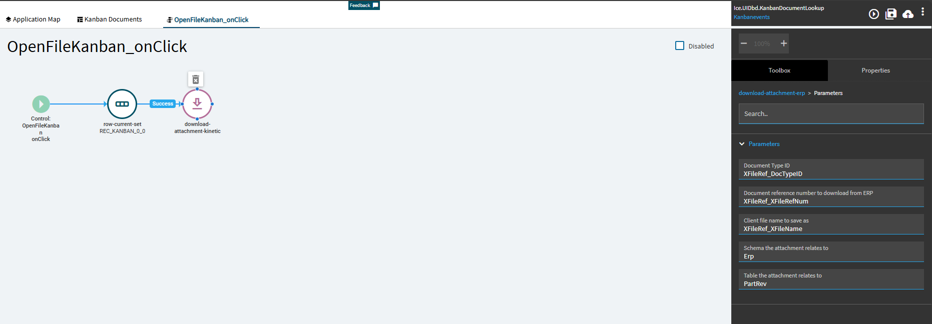

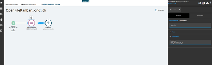

I don’t have a full answer for you but I had never goten a row-current-set widget to work before I found this guide. It’s specific to finding and setting a specific row and not necessarily multiple selected rows but it’s a starting point.
There is a Selector property you can activate in the grid. With that active, you could use a dataview-condition widget to check where you selector value is true and point your iterator to that file download event you made.
