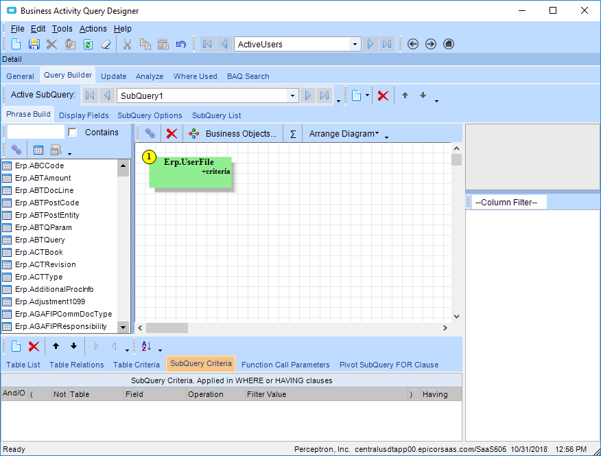

One way you could do it is:
SubQuery to get count linked to main query, then subquery criteria to ensure count > 1
The Having clause is located on the SubQuery Criteria tab:
