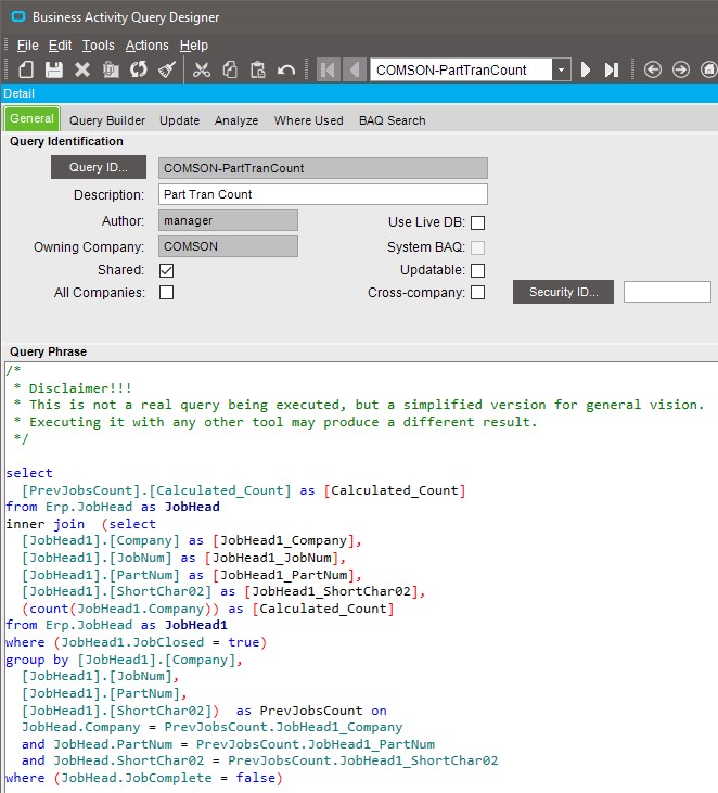

I am trying to create a query that gives a count of times a part/SN combo has been on a Job.
We repair equipment for customers and have been asked that if a unit has come in for repair more than 2 times to junk the unit. We create a unique Sales Order and Job each time it comes in, so I figured I would count the previous jobs instead of trying to count this against the SNTran table.
I was asked to be able to run this by all open jobs, so I have a query that is only pulling in Open Jobs. I am then creating a subquery pulling in the JobHead table again and linking it to the Top Level query by Company, PartNum, ShortChar02(where we store the SN). I am then creating a Calculated field and inputting count ( * ) (following an example in the ICE Tools User Guide). In the expression editor, it says Syntax OK; however when I go to the Analyze tab and click Analyze, I get an “Incorrect syntax near ‘(’” error message.
Even if I replace * with a field from JobHead, I receive the same error message.
I know the logic in the joins to pull the right records is spotty, but I can fix that later. I’ve checked the Group By boxes in the subquery that I’m using for my joins.
What am I missing? I feel like this should be simple so any assistance is appreciated.

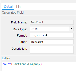

Thanks for nvarchar suggestions, but that isn’t working either. I’ve included screens below in case someone sees something I missed. I’m experiencing the same results in 10.2.200.31 and 10.2.500.2.
I even created a BAQ against PartTran where I only tried to count the TranType and that gave the same error message.
Out of curiosity can you rename your Field Name to something else other than Count
Because when I name my COLUMN Count I get the Error! Woot and when I change it to something else, it works.
Maybe thats what it was @JasonMcD
That was it, didn’t even think about the field name! Thanks!

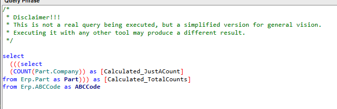

@tmcmullen you can also do Sub-Select SubQuery.
Then you wouldnt need to do GROUP BY on your Top-Query.
In a Nutshell:
  1. Make a Sub-Query but DO NOT Use it on the Designer
  2. On your TopLevel Query add the Sub-Query to a Calculated Field
  3. On the Sub-Query under SubQuery Criteria you can add WHERE Clause.
Example:
SubQuery1:
SubQuery2:
Result:
Basically in a simpler view it does
SELECT (SELECT count(*) FROM table WHERe...) as YourCalculatedColumn
It is proven that JOINs are usually faster and sometimes SQL will even convert your SUB-SELECT when it can, but if you get into a more complex scenario where you are getting tangled in Sub-Queries, GROUPS, etc… sometimes Sub-Selects work easier. FYI :slight_smile: thought Id share something.
The best time they work is when you need to get let’s say The Last Approved Revision nothing easier than a SubSelect and then Order By ApprovedDate DESC, but when not using Aggregate like count(*) then you must make sure you set your SubQuery2 to return only 1 row, 1 column.
