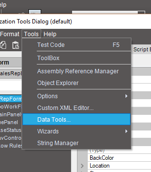

I recommend you use a ForeignKeyView FKV it requires no code and it is much more efficient.
Now if you want to do the adapter for adapter sake (learning) that’s a different story.
Then part will show up as an EpiDataView in the form and automatically lookup when the line changes.
That’s a good idea. I haven’t been able to get FKV’s to work before, this will be a perfect opportunity to learn it.
Quick question on FKV. The the view name that you type in whatever you want? Or is it something that has to match something. (Customization has some freetext fields that need to match exactly). A quick test seems to indicate it’s a “whatever I want” name, but I just wanted to be sure.
Whatever you want
