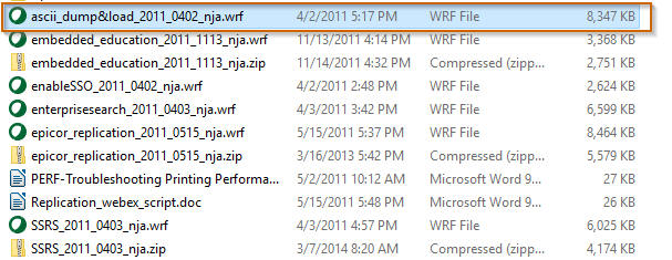

Where can I find the Ascii Dump and Load Kit that is suppose to free
It can be provided by Epicor Support.
