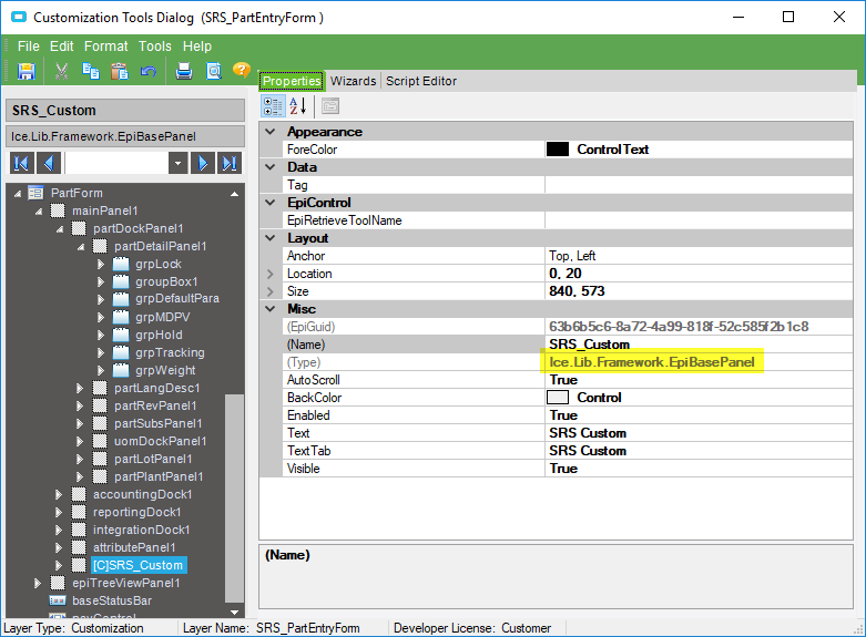

The custom panel has a name of SupplierPriceList, but that’s not a base type in Epicor. I can see how that might be confusing in the Part form because types were created for all the panels and the names pretty much match. Take a look at the properties for the panel and copy/paste the type on the line where you’re declaring the sp_Panel variable in the HideSupplierPriceListPanel() method.
If it’s an EpiBasePanel like ours (likely), then your code will become:
Ice.Lib.Framework.EpiBasePanel sp_Panel = (Ice.Lib.Framework.EpiBasePanel)csm.GetNativeControlReference("f7952705-e201-472f-8da3-f33228bc6075");
