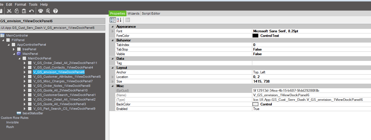

I have four tabs in my dashboard that I need to hide. I have selected them and make them invisible but it keeps the tab there.
I have also opened the XML and they are marked as hide.
I’m not great with script but if someone can point me in the right direction I can try that. I have also added this line of code but get an error:
Ice.UI.App.GS_Cust_Serv_Dash.V_GS_envision_1ViewDockPanel6 V_GS_envision_1ViewDockPanel6 = ((Ice.UI.App.GS_Cust_Serv_Dash.V_GS_envision_1ViewDockPanel6).csm.GetNativeControlReference(“5f12913d-34ea-4b15-b607-5fdd29280f8b”));
V_GS_envision_1ViewDockPanel6.Visible = false;
The error is Error: CS0119 - line 55 (3348) - ‘Ice.UI.App.GS_Cust_Serv_Dash.V_GS_envision_1ViewDockPanel6’ is a ‘type’, which is not valid in the given context.

You may need to declare a variable to access the panel.
declare a variable global :
private EpiBasePanel NameOfPanel;
then in initialyse code add:
NameOfPanel = (EpiBasePanel) csm.GetNativeControlReference(" the EpiGuiD value of your panel you need to access ");
and in the load event of the form try:
NameOfPanel.Visible = false;
Pierre

You need to share your customization code so that we can fix, otherwise it’s taking shots in the dark

try changing your Load method from
private void MainController_Load(object sender, EventArgs args)
to
	Ice.UI.App.V_GS_envision_1ViewDockPanel6 panel = (Ice.UI.App.V_GS_envision_1ViewDockPanel6)csm.GetNativeControlReference("yourControlGuidHere");
	panel.Visible = false;
and make sure it compiles before saving/exiting
Okay so the code Aaron_Moreng gave me worked. However, It is only hiding the grid on the tab and not the actual tab itself. I need to hide the entire docked sheet so there won’t be any tab showing on this.

	V_GS_UD09_Movement_1ViewDockPanel9 = (EpiBasePanel)csm.GetNativeControlReference("06c39f71-f266-4ccb-a3a5-996beedb575c");
	// Begin Custom Code Disposal
	// End Custom Code Disposal
	V_GS_UD09_Movement_1ViewDockPanel9.Visible = false;
Just replace the panel control with the appropriate control, which I wouldn’t know. It should still work

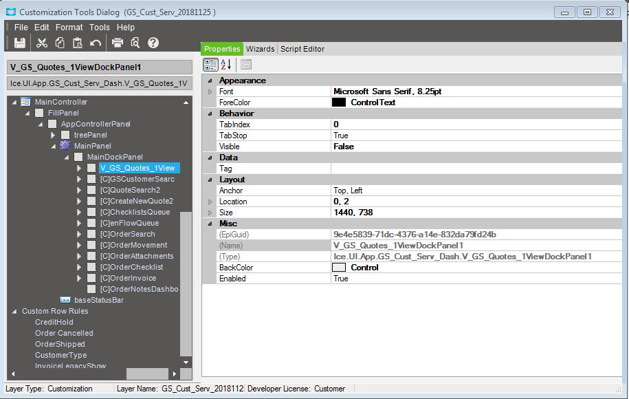

Anybody else have any ideas. Here is where I am so far:
	V_GS_Quotes_1ViewDockPanel1 = (EpiBasePanel)csm.GetNativeControlReference("9e4e5839-71dc-4376-a14e-832da79fd24b");
	V_GS_Quotes_1ViewDockPanel1.Visible = false;
And that doesn’t work?
No, it does change the property to Visible = False but the tab is still showing.
Make sure the GetNativeControlReference GUID is the correct one. it sounds like your GUID is pointing to the grid instead of the tab.
Everything is correct.
I did change it to this and still getting the same thing. Nothing is showing on the Tab but the tab is still there.
Ice.UI.App.GS_Cust_Serv_Dash.V_GS_Quotes_1ViewDockPanel1 V_GS_Quotes_1ViewDockPanel1 = (Ice.UI.App.GS_Cust_Serv_Dash.V_GS_Quotes_1ViewDockPanel1)csm.GetNativeControlReference("9e4e5839-71dc-4376-a14e-832da79fd24b"); V_GS_Quotes_1ViewDockPanel1.Visible = false;
It’s doing the same thing with other tabs…
