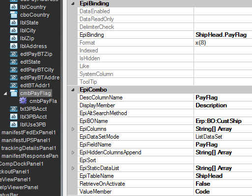

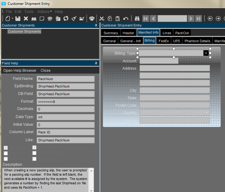

How can I hide (or rename) the Consignee option on the Customer Shipment Entry > Manifest Info > Billing tab?
It’s a dropdown list, but no reference or OpenWith option, so I assume Epicor has it hard-coded. We don’t use it, and would like to prevent folks from selecting it to mistake proof.

We’d like to have the rest of the Billing Type dropdown options available. Is there a way to hide just Consignee? The customization tools lists it as Array, but clicking it doesn’t break them out.

@jbryant - We couldn’t suppress Consignee, since it was a native Epicor list item. I ended making a simple little BPM that pops up an exception when Consignee is selected.
