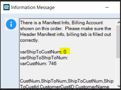

I know this was an old post, but I am trying to do the same thing that you have already accomplished. In my testing I found my method directives were not behaving as expecting.
For my test I entered a ShipTo-ShipTo account, saved the record, then I deleted the ShipTo-ShipTo account, to see if the Manifest Billing Info would revert back to the ShipToCust account (Like I had expected), but it did not. When I looked at the value for the ShipToCustNum it shows up as ZERO from the ds.OrderHed.ShipToCustNum and also from the formula: (from x in Db.OrderHed where x.Company == dsOrderHedRow.Company && x.OrderNum == dsOrderHedRow.OrderNum select x.ShipToCustNum).FirstOrDefault()

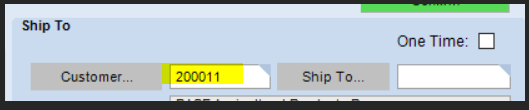

But on the sales order I am testing with, there is a value for the ShipToCustNum:
What am I missing?
Do a trace when you open the sales order. It could be the form is setting a default for the Ship To Customer if it evaulates as 0.
I’m guessing 200011 is the Sold To?

I am trying to work out all the changes a CSR might make when entering an order (and updating the Manifest Billing Info accordingly). When you open a new order, Epicor may default the ShipToCustNum to 0 (and then pull over the Sold to number to the ShipToCustNum). But for this case I am using a different SoldToNum than the ShipToCustNum. My testing was to enter a ShipToShipTo record, save it, then delete the ShipToShipTo record. My method on the ChangeShipToID, evaluates if the ShipToID is “” and if so then pull the Manifest Billing Info from the ShipToCustID, but I cannot seem to correct get that number (as it is showing up as ZERO for both ways I have tried to find it).
So you are changing it from Ship To Customer 200011 & Ship To Number XXXXX by blanking out the Ship To Number?
And when you do that, the ShipToCustNum is coming up as 0?
So I created the order with SoldTo 200669 and Epicor automatically puts that value in as the ShipToCustNum. Then I changed the ShipToCustNum to 200011, then I changed the ShipToShipTo to one of the locations, saved the record, then blanked out the ShipToShipTo field, the ShipToCustNum still remains 200011, but the variable I set comes up showing a value of 0 for some reason.
I think the issue was declaring my variables after some condition statements (and some declared in branches not taken). I think I have it figured out now.
