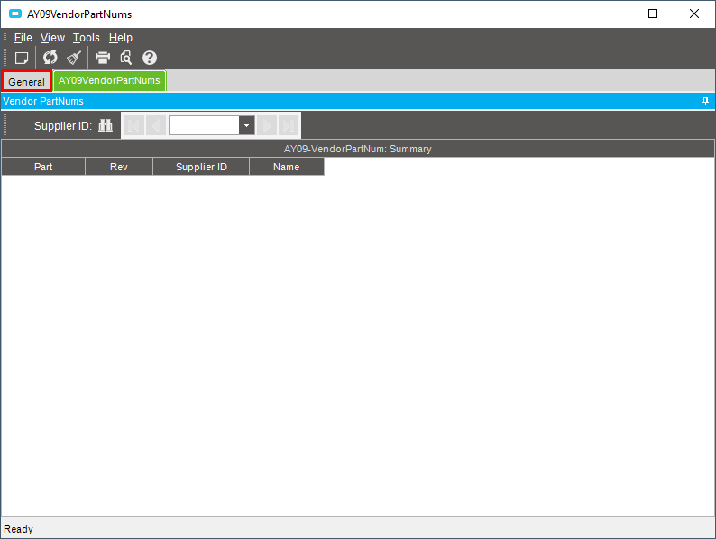

Is there a way to hide or remove the general tab on a dashboard?
Have you deployed the dashboard? It’s shouldn’t be on the deployed dashboard, just on the dashboard in development.
It’s the difference between a runtime and an assembly (compiled) dashboard. If you deploy the dashboard, you will have the option to add it to the menu as an assembly dashboard and that tab will go away.
Thank you! Changing it to an assembly dashboard fixed it.
