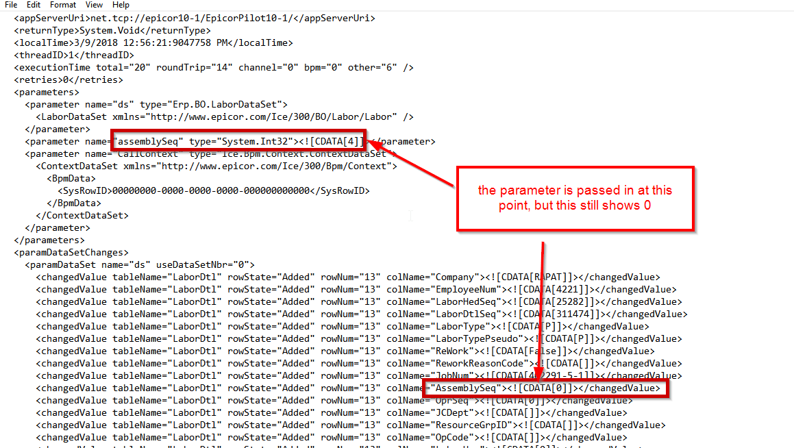

So when I am reading the data sets in the trace, it looks like the set that is shown after the BO is the state of the data set before the BO makes any changes right? So basically (I know this is probably stupid basic, buyt I’m just learning this) Whatever shows up in the parameters section of the BO are what I need to put in the expression part of the BO call. (like was mentioned earlier in the conversation, but I didn’t make that connection until now). So for the DefaultOprSeq call, there would be 3-1 parameters, so I need 2 arguments in the code. (it looks like “CallContext” is left out?)
la.DefaultOprSeq([“OprSeq”], out msg);
This would set my operation code in the data set, right?
So I wouldn’t actually manipulate the data set directly, I would call the BO to make the adjustments and pass along the required parameters. Right?
This is starting to make a lot more sense now.
Right that’s becasue the data you see is BEFORE the method call
