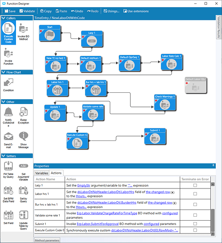

So #1, THANK YOU to @josecgomez and @Banderson for my new favorite post ever. From that discussion plus the Trace Parser, I actually made a function to create a labor transaction. I feel so smart!
My one complaint, though, I had to use a custom code block to set the rowMod on the Submit method for the labor to be approved.
Really? I did all of THAT with widgets and there’s no way for the submit method to work - ever - unless you throw some C# at it?!
COME ON!
For posterity, the code is
MyDataset.LaborDtl[0].RowMod= "U";
That’s it. No “usings” or any of that smart stuff. :stuck_out_tongue:
Yeah, yeah, I can live with that. But I just can’t believe I can’t even GET to the rowMod with the Set Field widget or that there’s not a parameter in the Submit method for that.

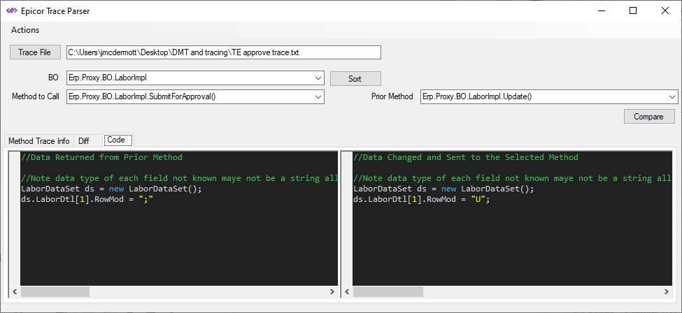

I remember trying the parser some time ago. I will have to re-visit it.

Biggest thing is what I never wanted to admit was true, but I always knew it. From that first post I linked to:
But with the tracer, it’s survivable. Just know that you need to fill in the parameters AND possibly do some field setting. But not always - a lot of the diffs are done by the methods without you telling it, like job part number. But then some need your help, like labor hours.
And you may need to set a stinkin’ row mod.

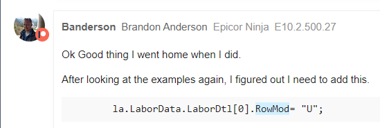

Also, here is where it gets muddy (muddier) for me. The post I used as a guide had this block of code:
But I used:
I tried Brandon’s code and got an error in the designer.
So I used a format more like Jose’s Trace Parser showed (there’s no “LaborData” portion):
It worked, so I guess that makes sense?? :face_with_raised_eyebrow:

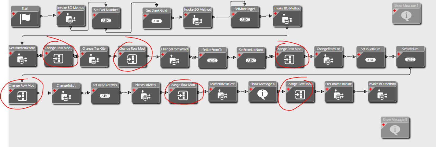

I finished a BPM on ABCCode.Update Post processing that transfers 10 units of inventory from one warehouse bin to another. I hardcoded everything that would normally be put in by a user (dynamic data) such as part number, warehouse, lot, etc… I am still learning how it all fits together. I also don’t think I am doing the row mod update correctly, do I really need to add it before each call?
