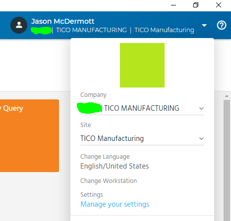

Not near a Kinetic screen at the moment but doesn’t the Active Home Page show the Company Logo? Don’t remember if it always displays or just in the Change Company/Site menu. But if it does, you can point to a nice sickly-colored green image to get a visual indication that you’re in Test in Active Home/Kinetic.

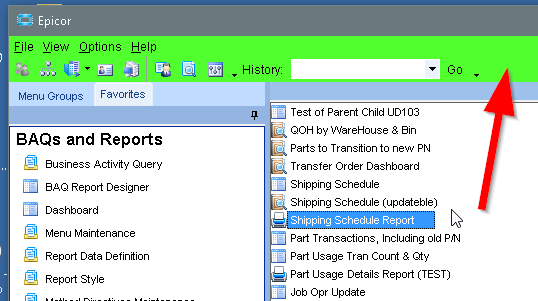

This it what I do with my theme :slight_smile:
@Mark_Wonsil Just the drop-down. Was definitely worth a try, though.
@ckrusen Um, Calvin, you didn’t really need the arrow. I was able to spot the green without it…
I was afraid of that.
How about the Employee (EmpBasic) photo? Just make it that pretty green for every user login. :man_shrugging:
