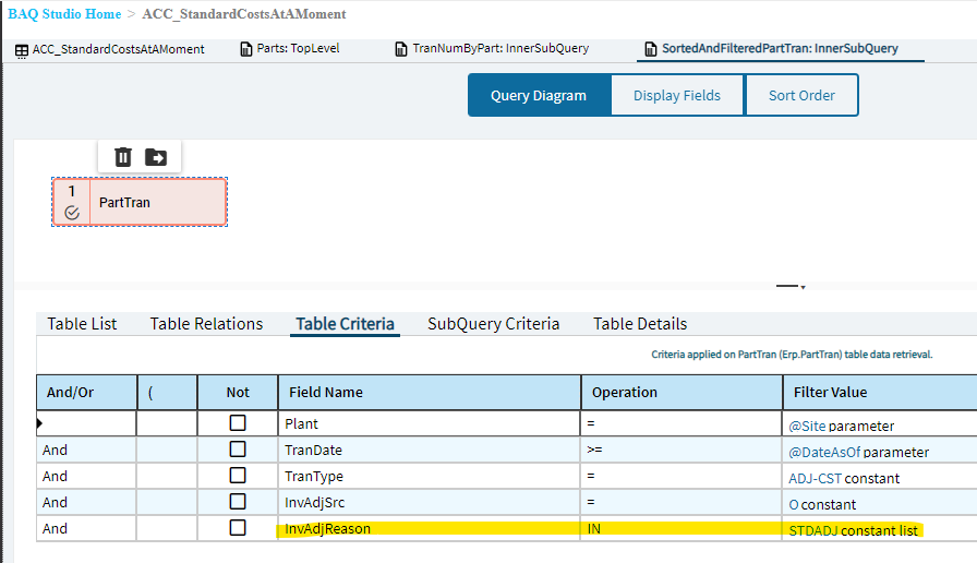

But to the original topic, I made a BAQ for historical std. costs a few weeks ago so I might as well share it.
Some caveats:
  • We use a reason code of STDADJ for setting a new std. cost, so you would need to change that for your business.
  • We don’t do cost roll ups; not sure how that affects other people that do.

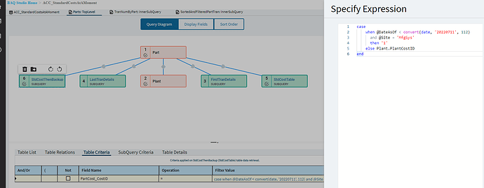

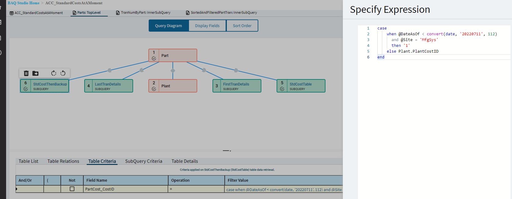

  • You may want to check my logic on the Plant Cost ID. Explanation :point_down:
So, we have 2 sites. The newer one, it has its own cost ID that is set up in Site Config (or wherever) and that woks great. But the original site (MfgSys) has no “official” cost ID; it uses the old default of “1” and so I reflected that in the join on the PlantCost table.
ACC_StandardCostsAtAMoment.baq (77.2 KB)

Anyway, like I said in 2021, there are some specific things you’ll need to change.
This is the big one - your company undoubtedly has a different reason code:
And then this… I don’t know what I was thinking here exactly…
EDIT: Ah, your table jogged my memory. It was this. Well that probably does not work for anyone else. But it’s left-joined so it shouldn’t break it - it’s just useless.
