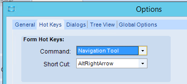

Speaking of Hot keys … I notice that the command Navigation Tool is available.

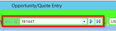

I thought it referred to the VCR controls in the menubar:
And hoped it would allow a single key stroke to move forward and backward within a record set. But it does not. The fact that there is just the one Command, and not several (like NavTool.FirstRec, NavTool.PrevRec, NavTool.NextRec, etc…) should have clued me in.
So what (and where) is the “Navigation Tool” command used for?
