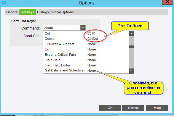

Choose “Options” on the menubar ( I think it’s under Tools), then select the “Hot Keys” tab.
From there you can assign functions to hot keys. Note that this is form specific. You’d need to do that on every form you open.
The is the Global options" tab, which will have it’s own “Hot Keys” tab. But the available actions to assign are very limited.

I use the hot key definition for programs where I use special functions regularly… example is in Product Configurator, where I ALWAYS setup F12 as the “Test” to eliminate multiple mouseclicks.
Note that in the Options window there are TWO places you can set the hot keys…
  1. there are GLOBAL options… these apply to all programs for the user:
  2. there are Program Specific Options… this allows you to setup any control or function key to any of the menu or options that are on that specific program where you run the Options:

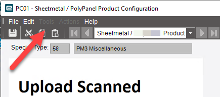

@timshuwy Wierdly the Tools menu is disabled when I go to load a configurator for configured part. Is there Epimagic to enabling this or setting it (perhaps through test mode)?
i dont believe that hot keys were ever enabled for configurators. probably due to the fact that these are all custom programs that are generated by the configurator.
