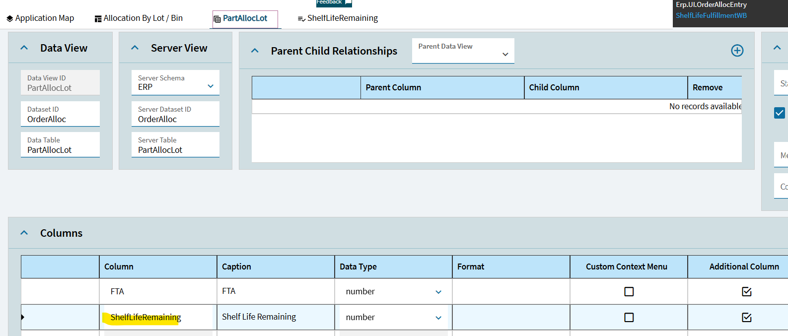

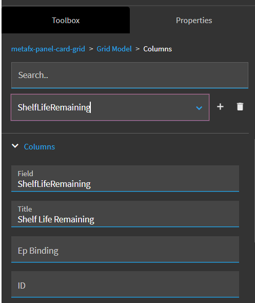

I’m working on a Kinetic Customization. I have added a new Column to an existing data view. The column has been added to the grid through: Grid Model > Columns.
I have also added it to the DataView itself.

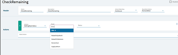

The field is being populated through a post processing BPM on the method which populates this view. However, when I try to add a Data Rule related to this field it does not pick it up. Does anyone perhaps have a solution for this?

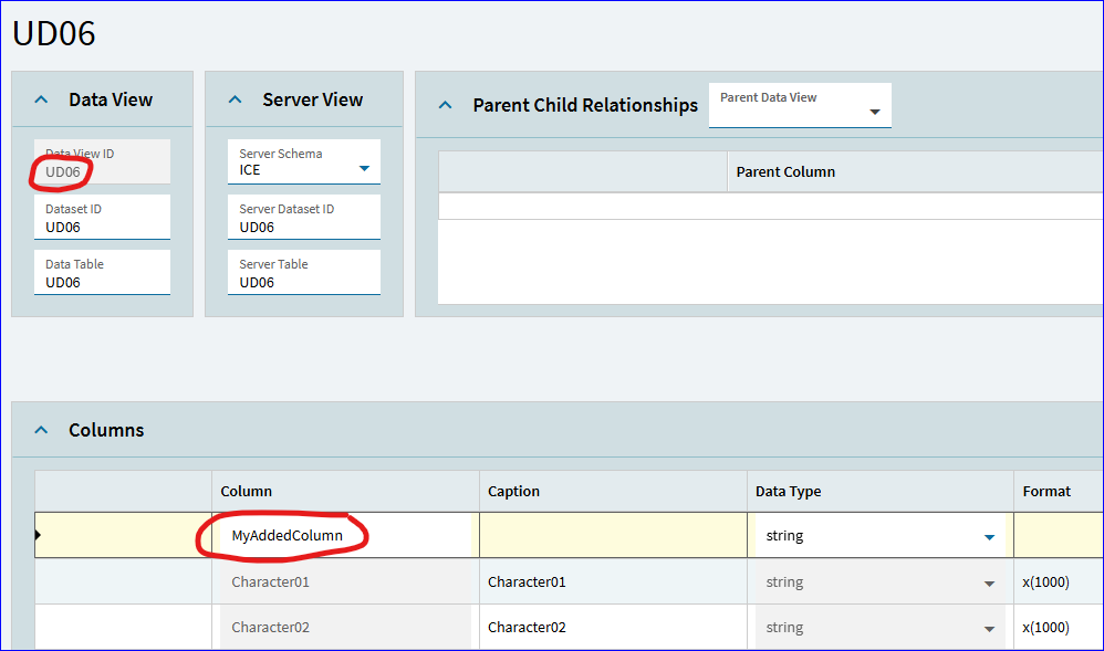

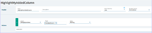

Works for me:

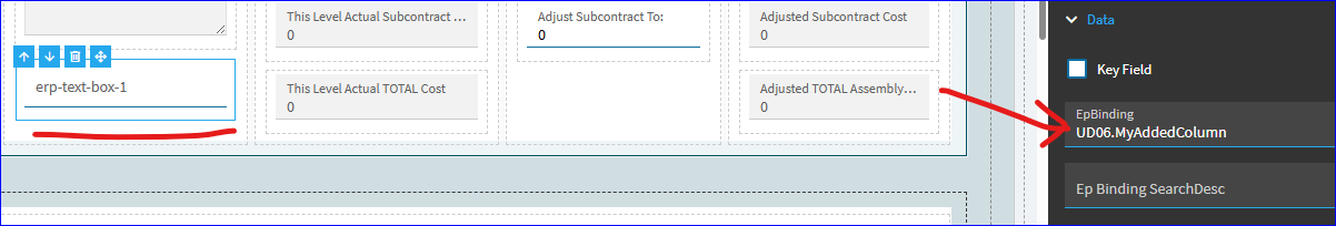

Added a textbox bound to that added column:

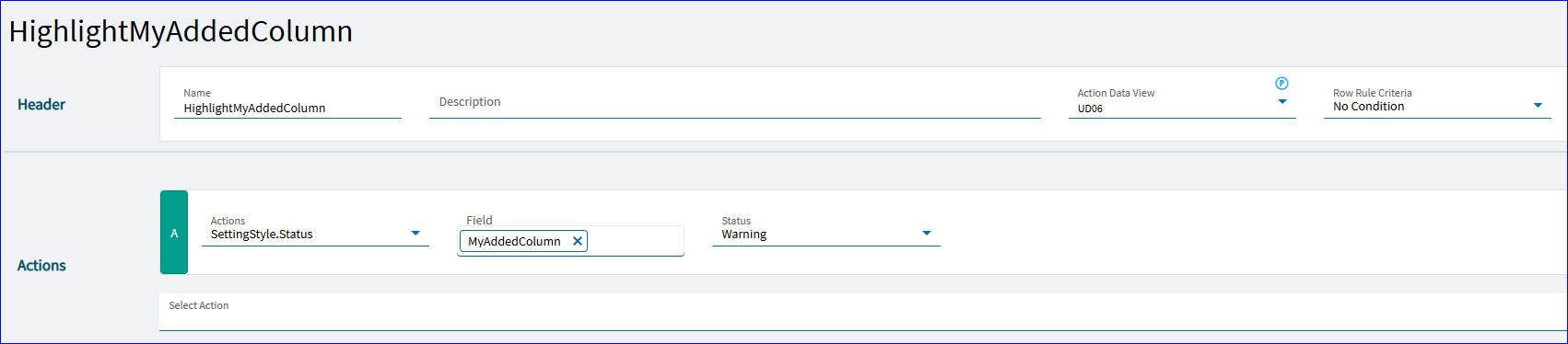

Created DataRule:

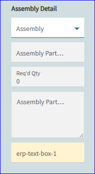

Preview:

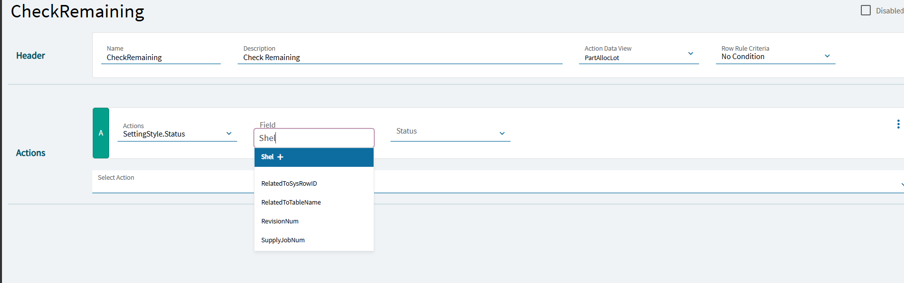

What does your Data Rule look like?
Hi
Not sure why its behaving differently on my side

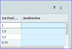

Just type it in and hit enter. It should stick.
I just tossed in “AnotherOne” to verify it works in a grid…
