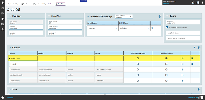

I am upgrading a C# customization. I am trying to add an unbound column to a kinetic dataview. This ends up being just being used in a button click when each row is completed. In C# I simply created a column and added it to the datatable with code. In kinetic I added it to the Dataview through the UI. It does not show up in the preview as I am assuming it needs to be bound to something. I can’t figure out how to bind it to Transview as I don’t need the information bound to a database column. Any help would be appreciated.

Add it to the same view as the rest of the data, then add it to the column list in the grid.

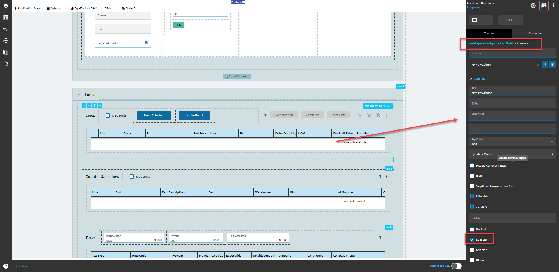

I am struggling with this. Every time I add the column to the grid the grid stops returning rows. What am I doing wrong?
You added it to both the grid model and the dataview?
Yes. It doesn’t show up in the drop down list I just type it exactly how it is in the dataview.
Yup–that’s how it should be added.
Can you verify if you’re adding it to the Grid Model > Columns or the Provider Model > Columns?
