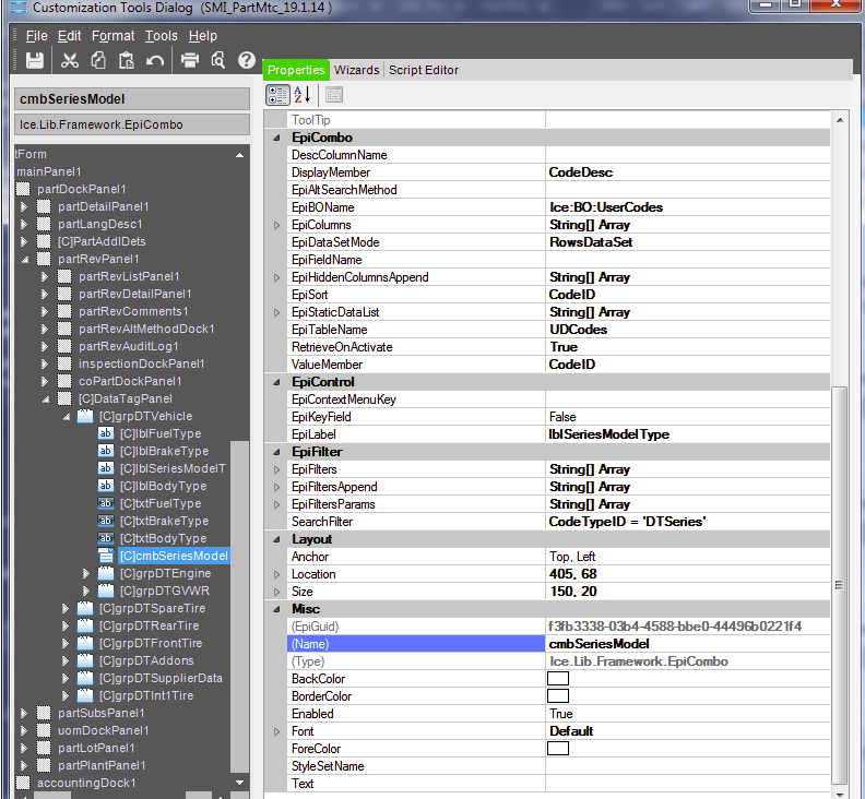

You should only need a customization and use a combo tied to the UserCodes table. Then you set the EpiBinding to the field that will be used to store the value. There should be several examples of this floating around the forum.
While this does not exactly answer your question, I keep this handy for EpiCombos. This is a huge feature of Epicor.
To use User Codes, you don’t need EpiFilters or EpiFilterParams. You would enter something like this in the SearchFilter field:
CodeTypeID = "SIZE"
The EpiBOName is all you need to select and it should populate the rest of the properties for you.

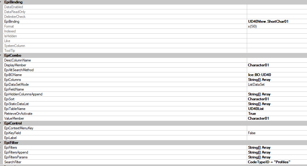

I’ve tried doing that, here is what it looks like:
I get an error as soon as I click the drop down, and it says to download the error log from the server. I have the download server file tool open, and I see no log to download. Any ideas?

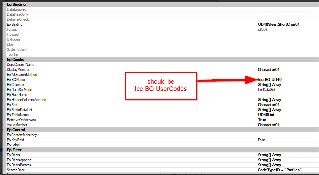

Perhaps I misunderstood, I thought your intention was to use UserCodes to define the selectable list. If so, your combo is wired up to the wrong datasource (you have it set to UD40, not UserCodes)
seems like there is some confusion on the topic here… the OP asked about UD tables… the discussion diverged into UserCodes (also called UDCode - making this an easy mistake)…

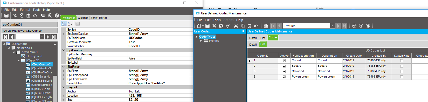

UDCodes are SUPER for Combo boxes… in fact if you define them first, and then in the extended table definition, you can link the field to the UserCode table… then when you add the combo box to the screen, it AUTOMAGICALLY puts things together for you.
To expand on what @Chris_Conn is saying, your Binding is correct, but the BO for the drop down you have set up for UD40.

You mentioned User Codes. This is UD40. Which one are you using? Also, Your binding is to UD40 as well. I doubt that is intended.

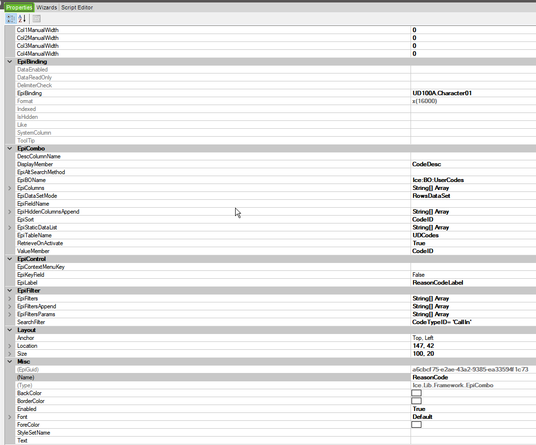

Here’s a more applicable example. UD100A table, Character01 binding. User code type “Call In”
Yes, I think you all are correct that I had the wrong properties set. I want to update the value in UD40, but I want the choices to come from the user codes.This is how I have it set now:
And as soon as I click the combo I get this error:
Can you show your epifilter settings? And I’m assuming you went into the User Defined Code Maintenance and made a list. (had to check).
You can’t have double quotes. Try singles. (see example above)

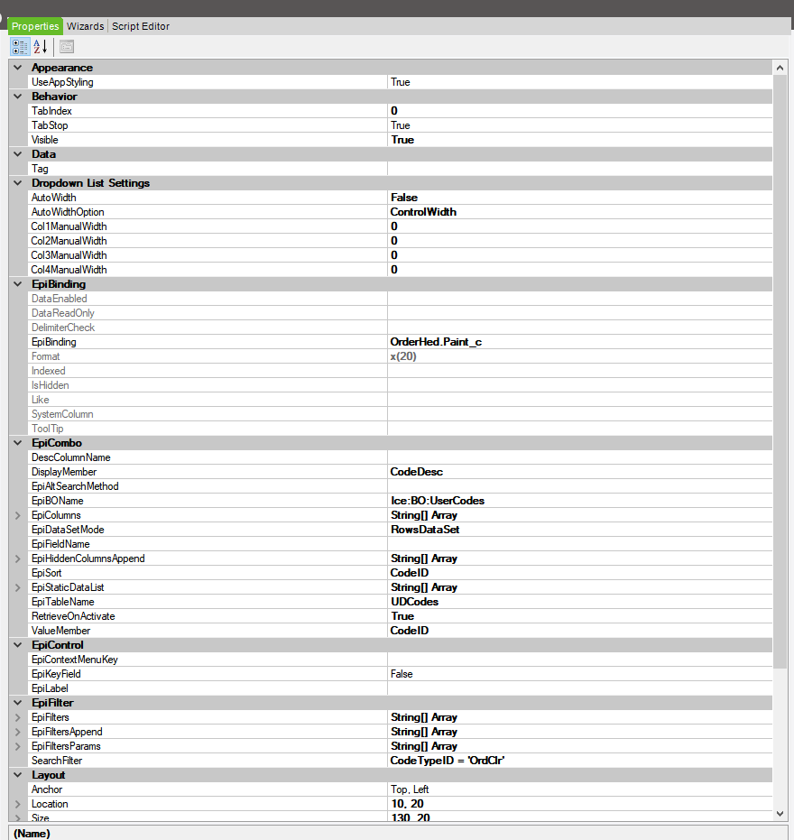

Now I get “Cannot find column CodeDesc.” I tried CodeTypeDesc as well, got the same message “Cannot find column CodeTypeDesc”
Ah, I changed EpiDataSetMode to RowsDataSet instead of ListDataSet and now it works.
It’s RowsDataSet not ListDataset (That’s IMportant)
Also the Table Name should be UDCode and the BO is incorrect
