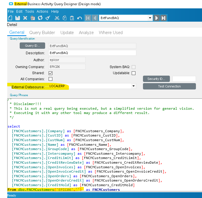

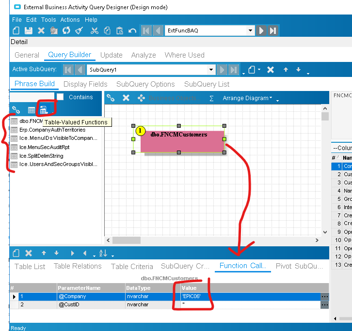

You need to create an External BAQ for that. Setup your external datasource, give company access to it and then do the following:
Create new ext baq to the (epicor db) datasource.
Click on the Table-Valued Functions, add epicor or your function and enter the call parameters.

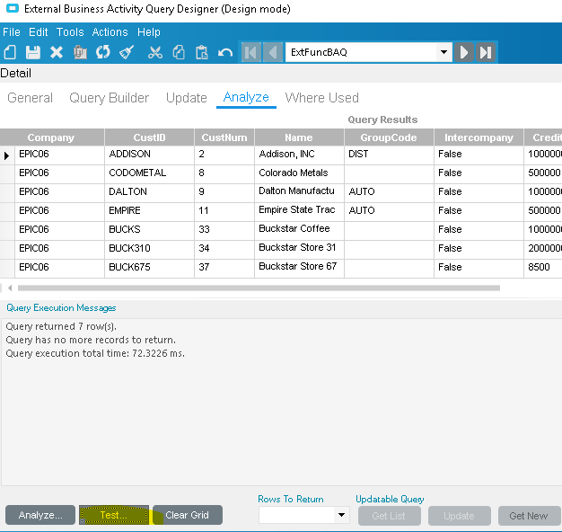

Test.
