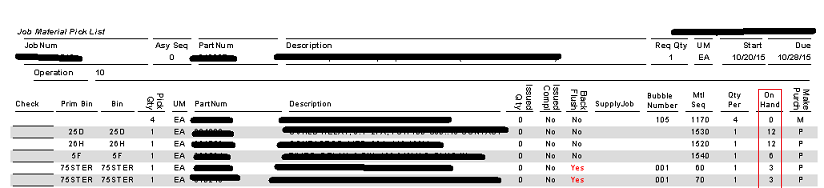

I’m sure there are much more elegant ways (a dashboard perhaps), but you could just print the Pick List and look at Mtls with no On Hand qty’s
See how Mtl 20 is missing the QOH?
Would the Production Planner Workbench be an option? I like that as a quick overview of jobs with all material vs jobs with shortages.
How do I get this? Exactly what I need!!!
It’s the built in report.
Production Mngmnt -> Job Mngmnt -> Reports -> Job Pick List
