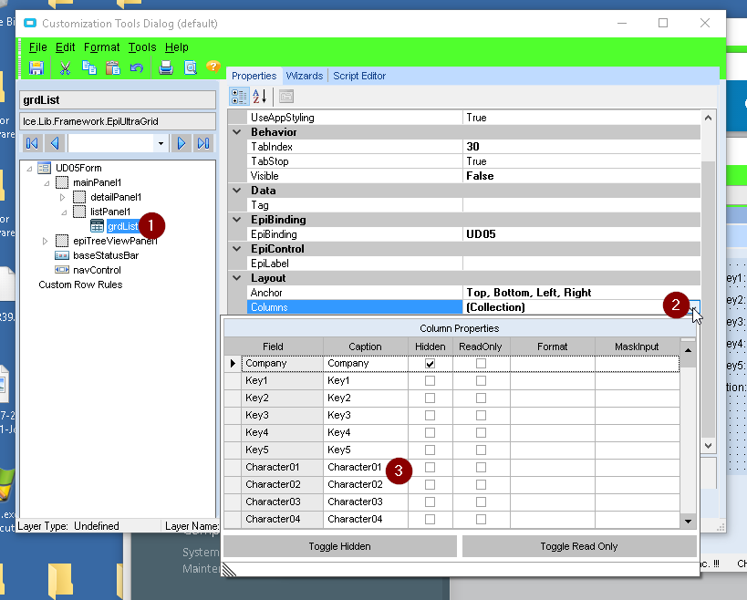

Thanks a lot, is it possible to change the column labels in the corresponding table?
Yes. You have to do it through customization mode.
And as a heads up, don’t kill yourself trying to hide the Key fields that you don’t use by setting their control’s visibility property. That won’t work. You have to do it through extended properties. Or what most people do is change their position to out of the visble form area (change position from 10,200 to 10010, 10100)
edit
After entering Customization (Tools -> Customization on the form’s toolbar)
  1. Select the grdList item
  2. Click the Columns (Collection) dropdown
  3. Edit the column names as desired
