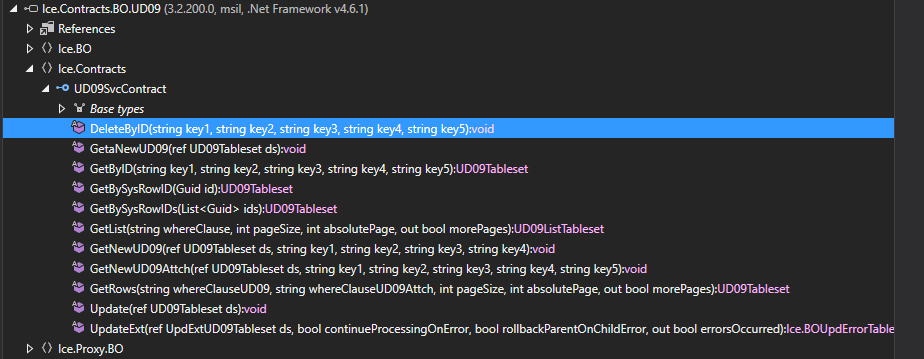

we are upgrading to 10.2, does anyone know if this the function to delete UD table data is included?
I see a DeleteByID available. I’m on 10.2.200
