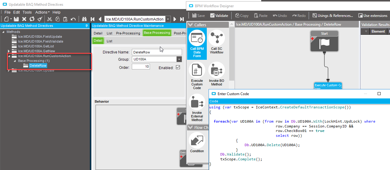

I need the ability to delete a row in a child UD table (UD100A).
There is no DeleteByID BO on the UD100A table so I cannot “Invoke BO Method”.
I defined the CustomAction as “Base-Processing” BPM and called it “DeleteRow”.
The code compiles and runs without error, just that it does not actually delete the record.
Can anyone offer a suggestion as to why this is not deleting?:
using (var txScope = IceContext.CreateDefaultTransactionScope())
  foreach(var UD100A in (from row in Db.UD100A.With(LockHint.UpdLock) where
                              row.Company == Session.CompanyID &&
                              row.CheckBox01 == true
                              select row))
                Db.UD100A.Delete(UD100A);
     Db.Validate();
     txScope.Complete();

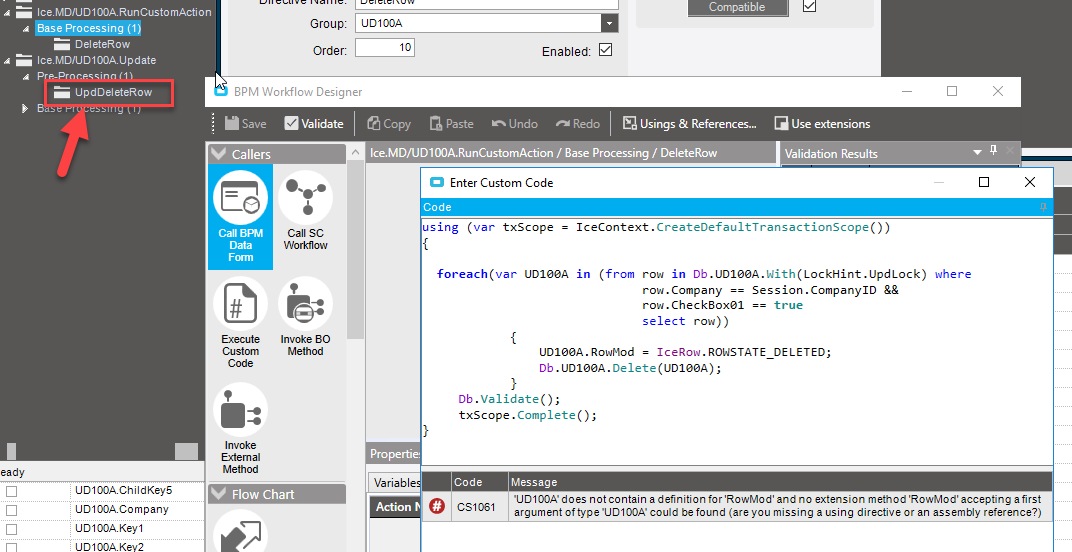

Yes, before the Db.UD100A.Delete(UD100A); line you need .to set the RowMod also to “D”
Example:
UD100A.RowMod = IceRow.ROWSTATE_DELETED;
Please do yourself a favor and use the BO
No go. It does not like this line of code.

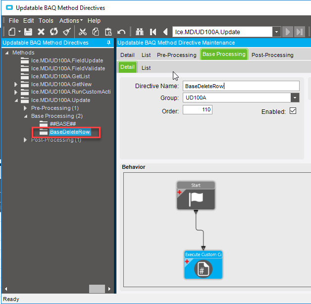

Thanks Dan, putting the “Delete” code in the BO UD100A Update >> BaseProcessing works.

No, I did not modify the ##BASE## processing Directive.
I created a new Directive with the original code I posted and the functionality is working as I would expect.
