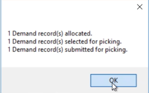

FWB > actions > allocate > by lot/bin > continue > ad-hoc allocation template select release to picking > Fill in QTY and you should get this
Say no to the next prompt and it will keep it in the material Q.
Now go to Material Request Q. Probably worth creating a BIN called SHIP and moving qty to that bin. Create cust ship entry and go actions > picked orders.

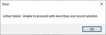

On the allocate by lot/bin, it didn’t work for me, so I did by part instead. And now I try again and it seems to work OK. So, what is the effect of that? Help guide just says “You can also select to allocate by lot/bin or serial number.” That explains a lot.
Edit: OK, now I see the lot/bin problem:
I see the allocation happen but no MtlQ record is created? I’ll have to toy with this some more.
