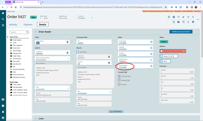

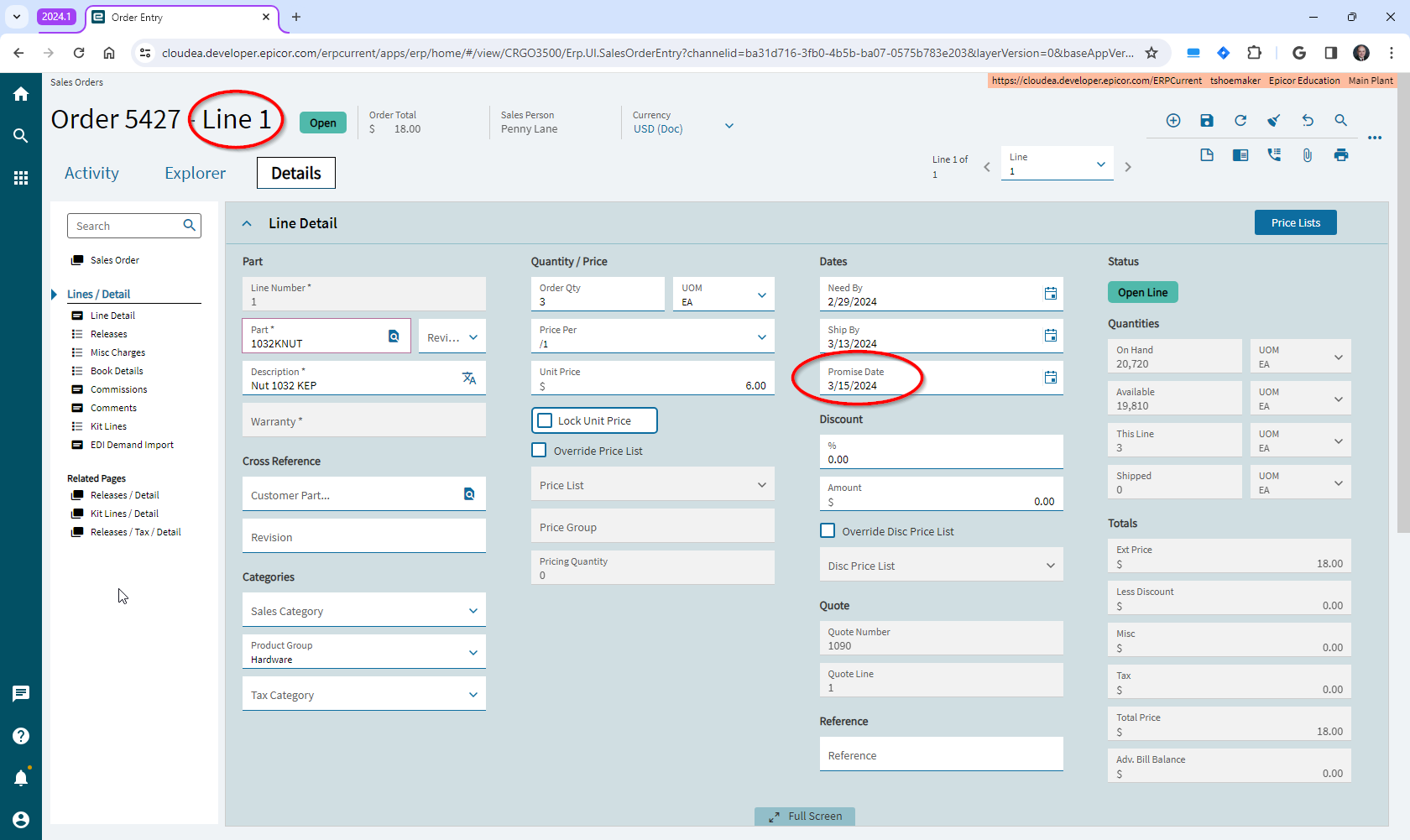

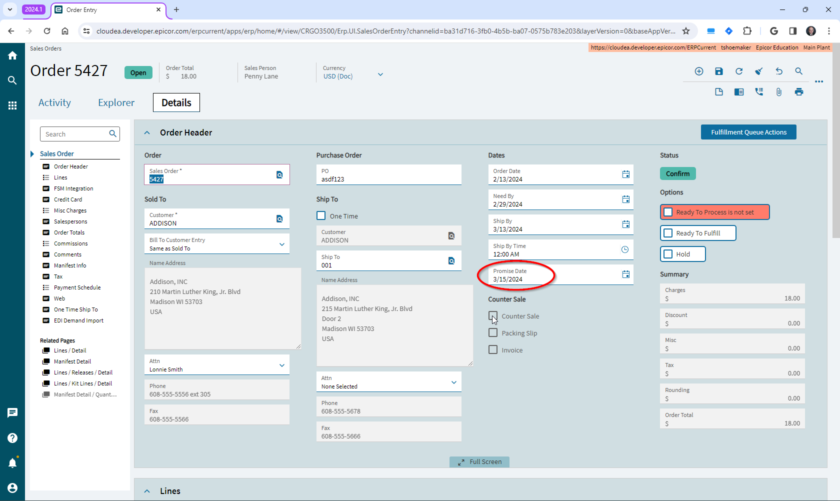

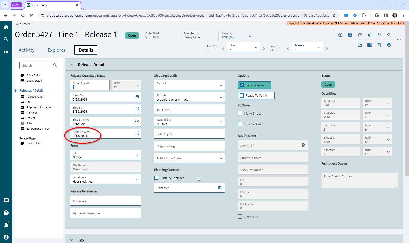

OK, so agreed, then, it makes perfect sense and it is ridiculous that it is not part of the system?
Sold. I’ll put in the Idea and update this.
Also I saw in one of those posts that it is an existing enhancement request, but I think it is established fact that Development threw all those in the trash when Ideas came along, right?
Idea 1873
https://epicor-manufacturing.ideas.aha.io/ideas/ERP-I-1873

We recently received a request to add “Promise Date” to the Sales Order. Would be nice if Epicor would prioritize this but given how slow they are to fix issues…I am not holding my breath for a “Future Consideration” :face_with_hand_over_mouth:
Thank you for the upvote, though. :slightly_smiling_face:
