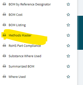

Use the out of the box Method Master report. Then do what @klincecum said. If you need any more help, let us know.

You don’t have to. Use the Methods Master report.
